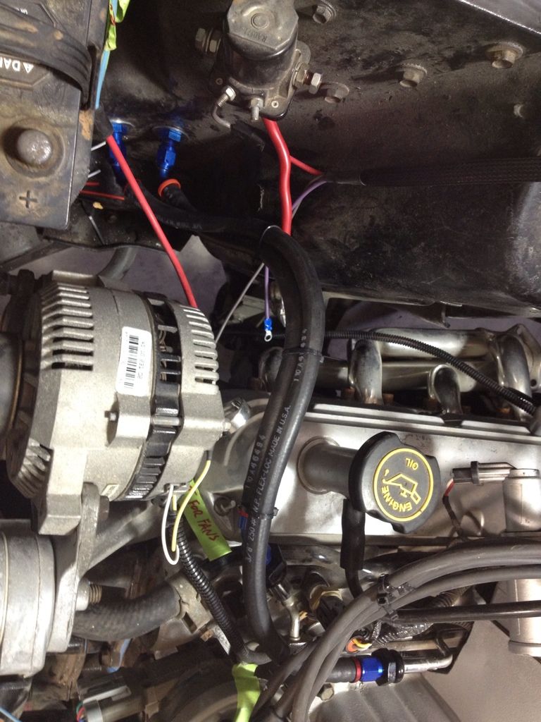

update. I went by to check on the car. It's coming along nicely. I got some pics, but need to get some more. The wire harness is all in now. Got a few minor connections to make yet, but the main part is done. The dash is all put back together. Also, they found a short in my steering column so they replaced the turn signal. Also got all the a/c ducting run.

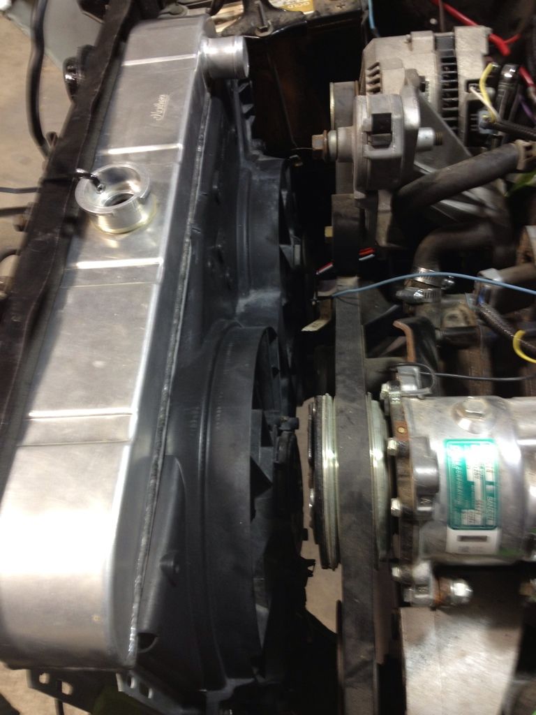

Got the radiator mounted and the fan from the contour is in. The wiring was simplified so that a 190 degree switch turns them both on and its tapped into the thermostat housing.

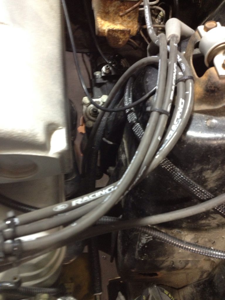

what you are looking at in this next pic is the hoses for the power steering. We went with steel braid lines wrapped in fire sleeve (very bottom middle you see it exiting the sleeve). This allowed me to not have to run the lines up high.

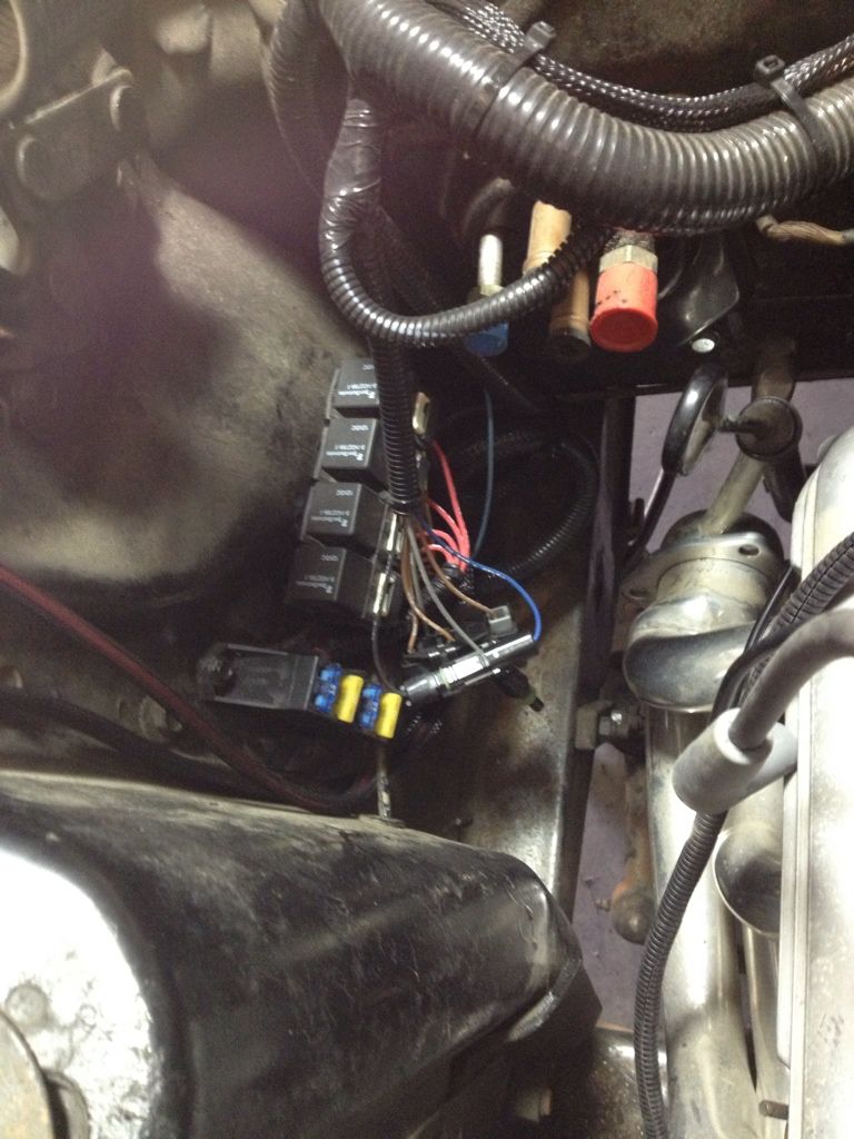

these are the relays and fuses for the RJM EFI harness.

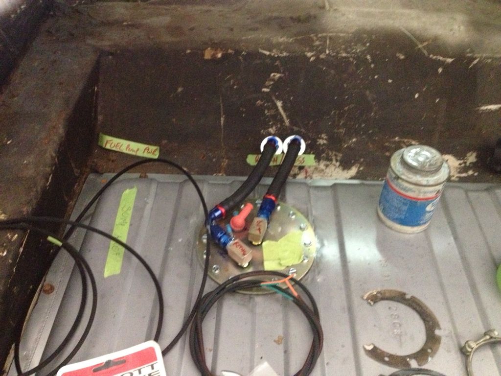

Heres the high pressure fuel lines. We ran the high pressure on the outside of the subframe connector and the low pressure return is on the inside as there wasnt space to run both outside.
Here's where the lines come into the trunk and the in tank fuel pump.
