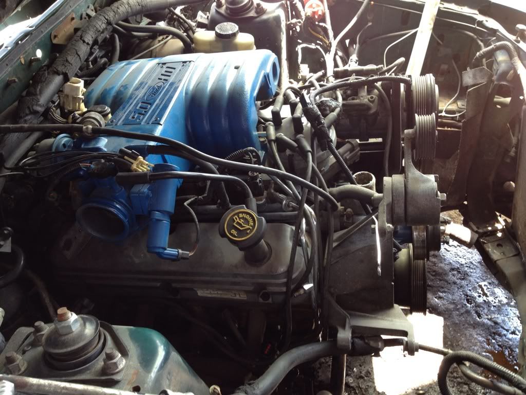

Ok, got an update. I hit the junkyards today. I had looked on ebay and found the serpentine brackets for all but the AC and it was going to run about $275 plus shipping. Then I needed the timing chain cover for about $160. Add to that that Im still needing a starter, MAF, ignition coil, cold air intake etc.... it was gonna add up. I walked into a parts yard and they had a 91 mustang LX. Motor still in the car and it was freshly rebuilt, all the gaskets are new. It was only missing the alternator and smog pump. I picked up the whole engine with the starter, cold air intake and even the radiator shroud. Now this opens another can of worms. This has the salt and pepper shaker connections and I have the complete harness from the 94..... so since I have to pair down wires anyway, do I follow the wiring diagram, and rewire. I can get the wire harness from the car for $100 but the did break some of the clips. I will still have to strip it down and make it work. But at least I can fit the motor in now. I also got the monte carlo shock tower bar from the car. I know it wont work, but I'm hoping I can use that as a platform to build the one for this car. Im hoping the Alternator from the 94 will bolt up. I will tear this one down to to confirm that its been rebuilt. I will use my heads from the 94 that are being revalved. This motor had stock headers so I wouldn't think there's been any mods like a cam etc. If they wanted that I would have expected to see more than just a K&N cold air intake. When all is said and done, I will put the 94 back together and try and sell it maybe recoup most of my money.

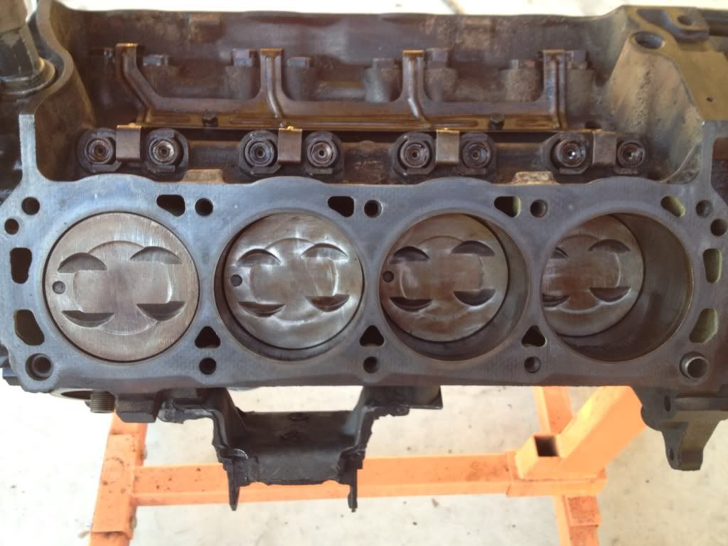

wow..... So I tear down the motor to see what I got and if it is actually a rebuilt motor. My first hint that their might be a problem when I noticed there was no dipstick hole on the driver side of the block. Then I pulled off the intake and no roller lifters. So, they got a shortblock and put the heads on it. It's not a total loss. I will take the parts I need and put it on my modern block and then sell the long block. I should recover most of the money I spent on the motor and I got all the extra parts. I'm going to call the salvage yard monday. They had a guarantee on the motor. It may have run, but it would have run like crap, without the roller cam, I suspect. I dont think I'll be too hard on them as I got everything I wanted and then some. But, I will see if they will give me the wiring harness to make up for the motor not being all it was supposed to be.
txtrailerdaddy1 is offline

Man, what a bummer on the block! But don't try to splice the '94 to the Fox harness. Get the complete harness out of the same car the motor came out of. Use the wrong block as a bargaining chip.

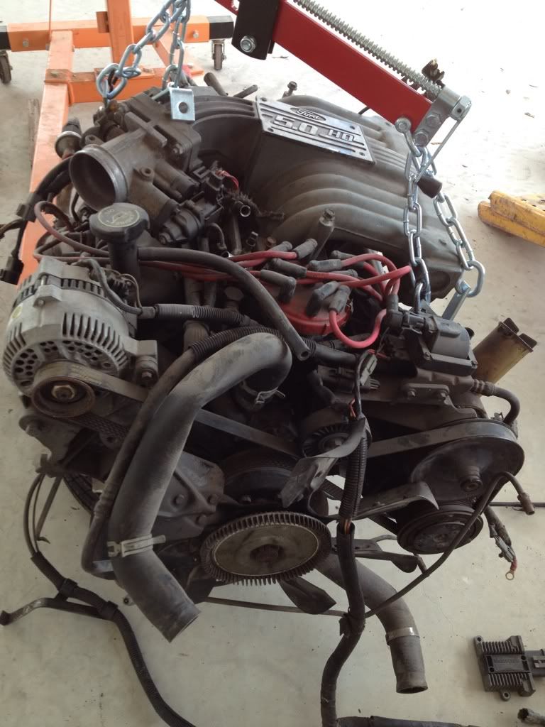

Ok got some pictures uploaded so I will try and post them.
My car.
The 94 donor motor

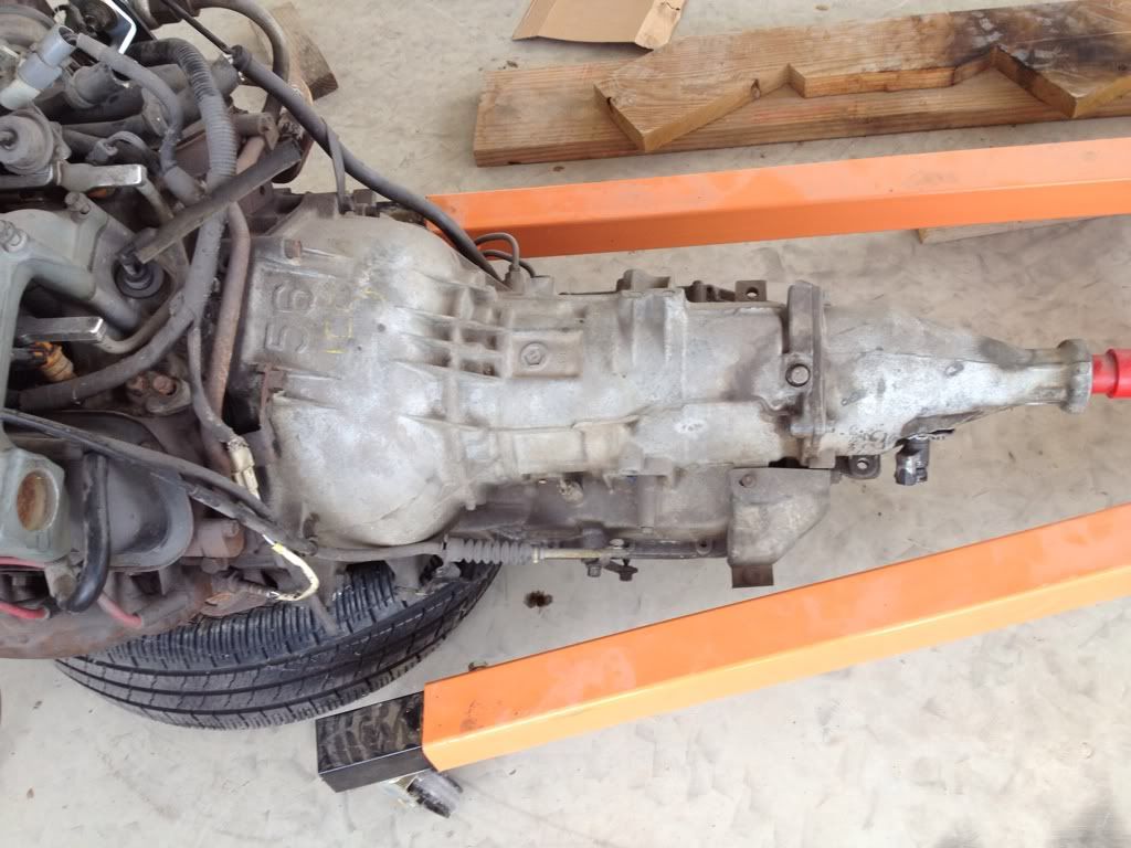

The AOD (which should have been an AODE but it worked out)

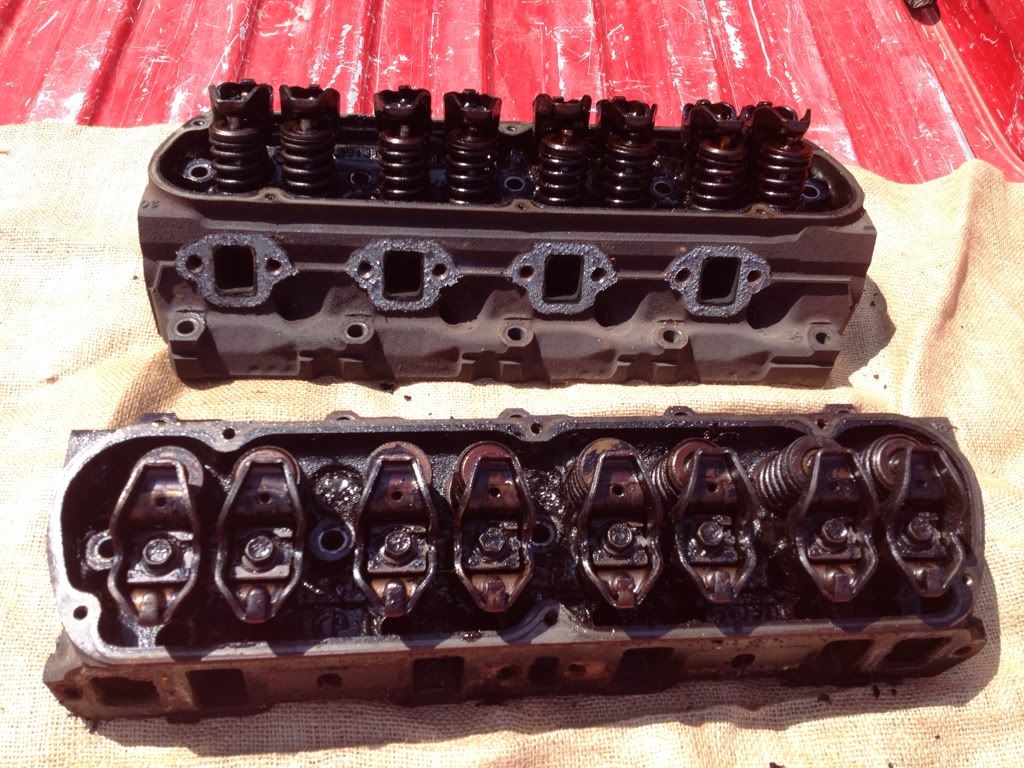

The Heads off the 94 (currently being ported & revalved to 1.94 and 1.60 and adding studs and roller 1:6 ratio rockers)

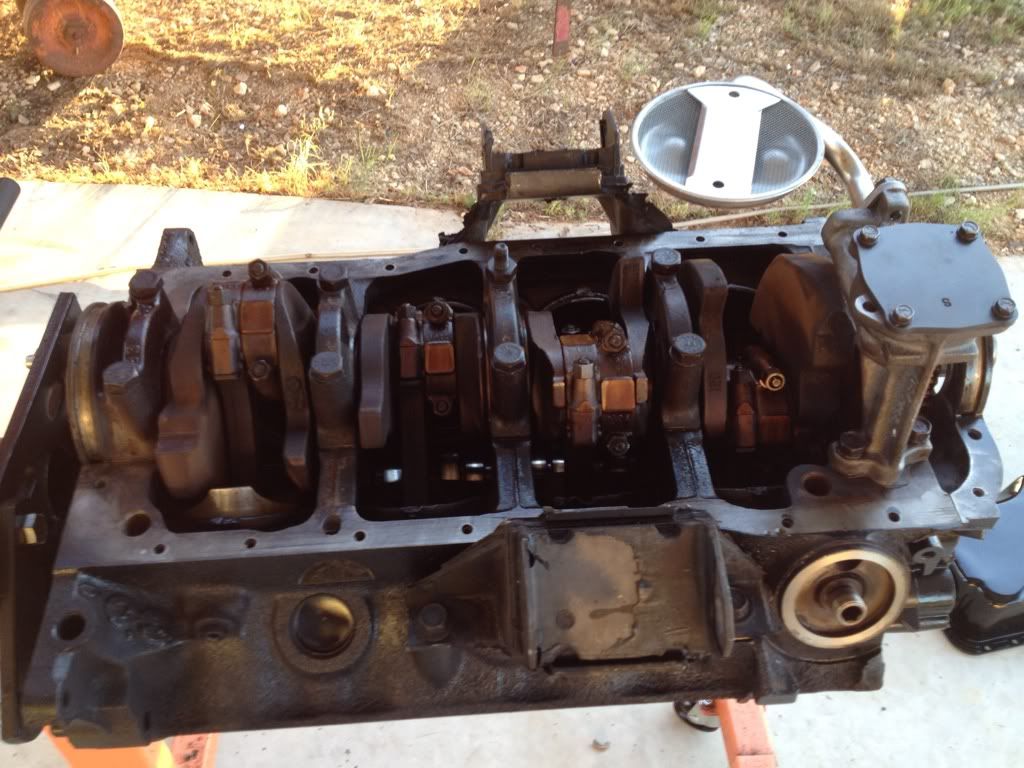

The block torn down. Very little wear on the cylinder walls. not a lot of sludge in the valley pan.
This is the motor out of the 91 that I got. supposedly JUST rebuilt and runs strong.
Can you spot the problem?
how bout now

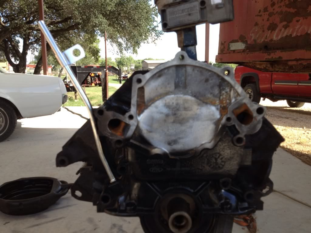

The timing chain cover for the 91 about to be drilled. I drilled from the inside out as it gave me more room to get the right angle without buying a long bit.
And after its drilled.

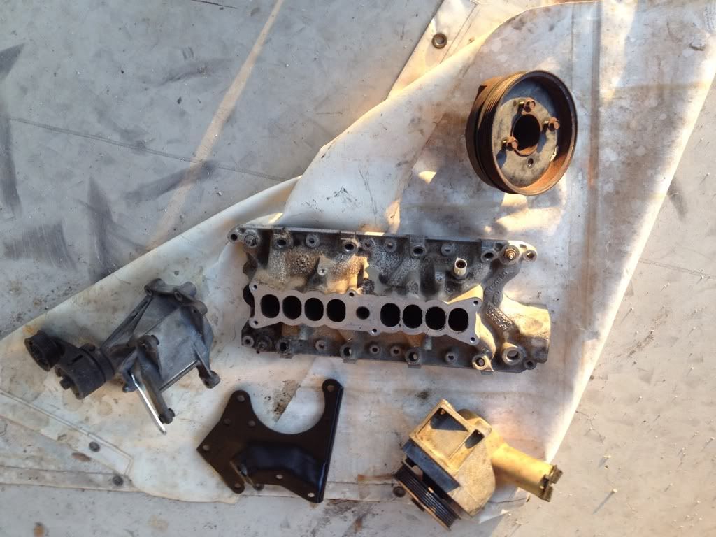

Intake and some accessories gotta find something to clean that aluminum...
New oil pump and pickup and the bottom end after washing the block with diesel.

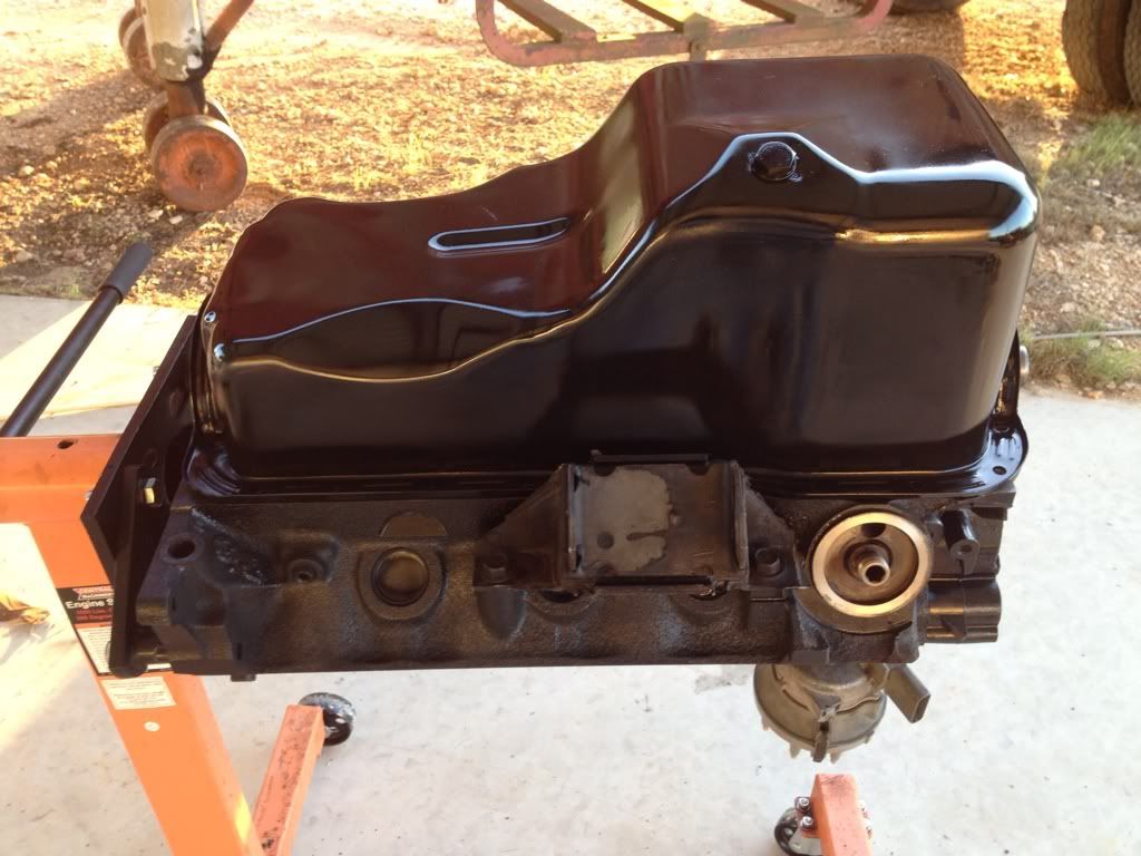

Oil pan painted and set in place
