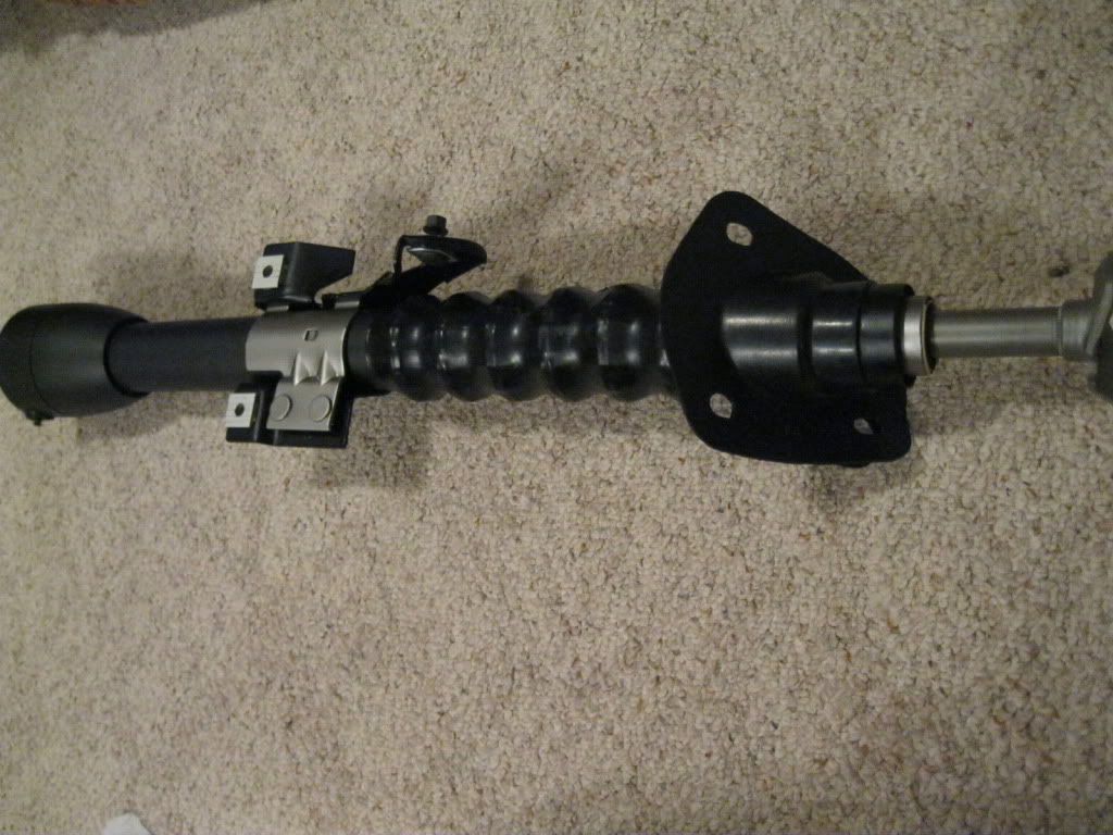

i know you've seen this but i thought i would append it as data to this website.
1. Rust-Oleum Professional Stainless Steel (7519)
1a. Rust-Oleum Professional Stainless Steel (7519) w/Krylon Clear Satin (1313)
2. Dupli-Color Gunmetal Gray (T177)
2a. Dupli-Color Gunmetal Gray (T177) w/Krylon Clear Satin (1313)
3. Dupli-Color Machinery Gray (DA1612)
3a. Dupli-Color Machinery Gray (DA1612) w/Krylon Clear Satin (1313)
4. Seymour Stainless Steel (16-054)
4a. Seymour Stainless Steel (16-054) w/Krylon Clear Satin (1313)
5. Dupli-Color Cast Coat Aluminum (DE1650)
5a. Dupli-Color Cast Coat Aluminum (DE1650) w/Krylon Clear Satin (1313)
6. Seymour Aluminum (16-1201)
6a. Seymour Aluminum (16-1201) w/Krylon Clear Satin (1313)
7. Aluminum Oxide Media Blasted
8. Aluminum Oxide Media Blasted w/Krylon Clear Satin (1313)
9. Natural Steel
the above sample did not contain Eastwood's Detail Gray.
in the below sample, i used Eastwoods Detail Gray on the tube that connects to the rag joint. Rustoleum Professional Stainless Steel as mentioned above is used on the tube that is right next to the tube connecting to the rag joint.
i've been trying to alternate different products on different parts for some contrast. None of them look like natural steel in my opinion, but when it's not right next to the natural steel part, it doesn't look so bad from a few feet away.
