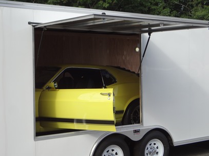

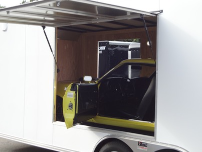

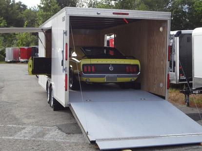

This is a few pics of the door opening when I first tested the awning door opening. Definitely makes getting in easy. I did the test with my lowest sitting car which was my 70B2.
Also the front spoiler just clears the ramp, so no additional ramps or build ups are needed.
+1 on the comments from others: radial tires, torsion axles, welded plate in front for the winch (needed once so far at the track).
Only thing I do not like is the end of the ramp door has a plywood piece that flips down to ease the entry, gets wrecked at the edge. That will be diamond plate eventually.
