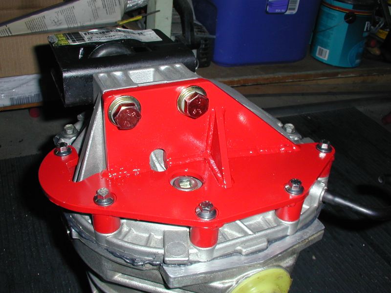

Had a machinist make me an aluminum rear diff bushing
Here's my front diff bushing mod:
So I didn't have to buy this:
diff bushing
I made this:
based off of this:
I modified the stock torque brace to bolt in with the diff bushings:
based off this:
