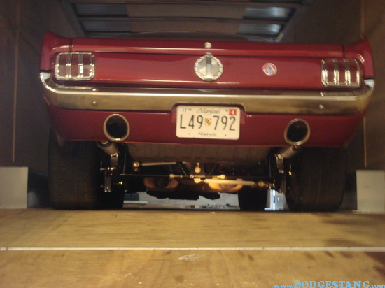

Guys running four links in your 65-67, show me how you've tackled the interference problem. My panhard bar is leaving me little room to run the exhaust from the mufflers back out to the stock location. I'd rather not run it out the side if avoidable.

Under the axle, side exit, or dump before the axle are probably going to be your only options.

I dump right before the axle with turn downs. No issues with exhaust smell etc...
I've seen fellas run it under the rear axle housing with success.

Dr.Stang,
Do you have a rear shot of your car? I'm concerned about droan coming into the cab using turn downs.

Posts: 1,789
Here's my under car.
