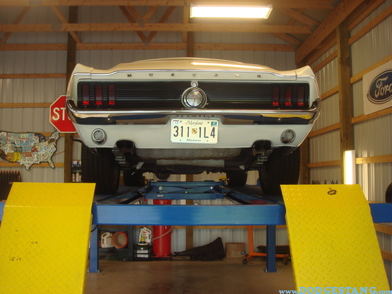

Just keep your eyes out for original....I paid sub $300 for mine (it had 2 of the pop metal stubs broken off but I just bolted it on with a phillips headed bolt and painted the bolt black )
If you look close you can see even when new...they weren't perfect....but it did at least fit (and you can see my unbolted replacement bolt in the lower driver side below the tail light)

thanks for the pic dodgestang.
i think i may wind up buying another set of the 6 light bezels and powdercoating those black and then adding a vinyl wrap to the back panel. that way if i get sick of the look i can put it back to stock with minimal effort.
