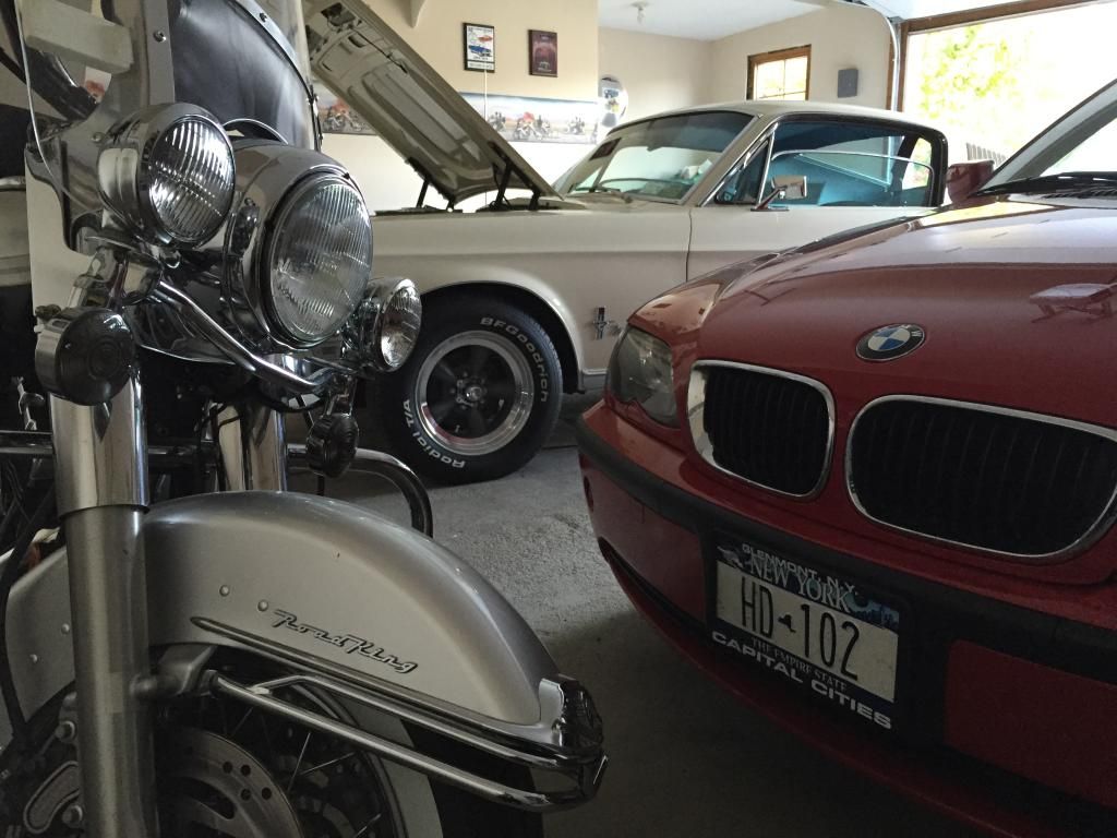

Harleydave's Avatar
Location: Livingston, New York
Posts: 2,623
15". If you want something that handles, get a BMW.
68 Fastback.
351Windsor, 4sp, 8" 3.40 TracLok
http://forums.vintage-mustang.com/bu...ld-thread.html
Harleydave is offline
