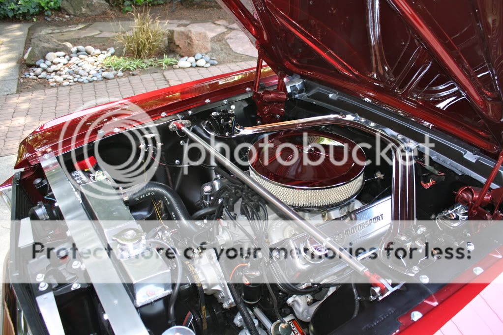

Here's mine:
4 Row. Ordered a 3 row but they sent a 4 row. Called them and they said just to keep it. Talk about customer service!
yarb likes this.
