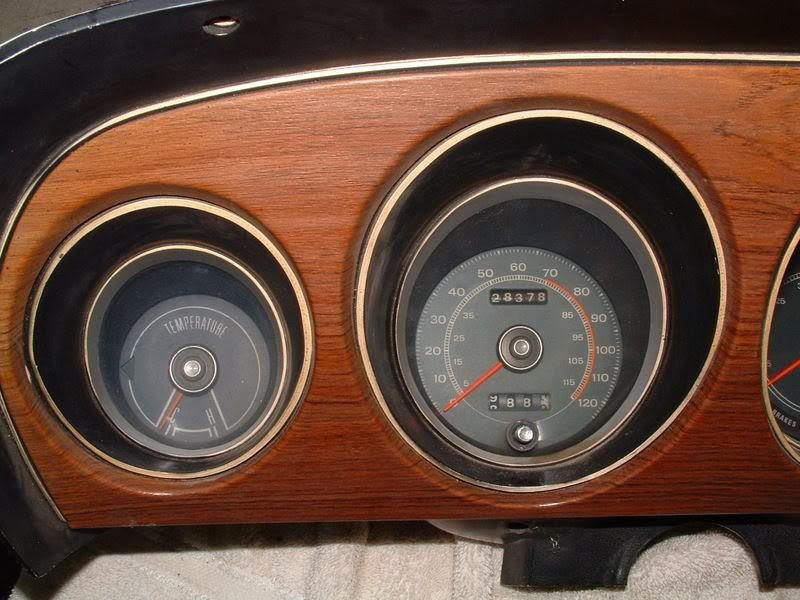

Did a search and can't come up with anything. I know that the chrome portions on this bezel are a tough and expensive restoration, so many of them appear yellowed from age (like mine). I remember reading that some have resorted to painting these rings. Can anyone share their experiences in trying to improve the looks of their bezel?

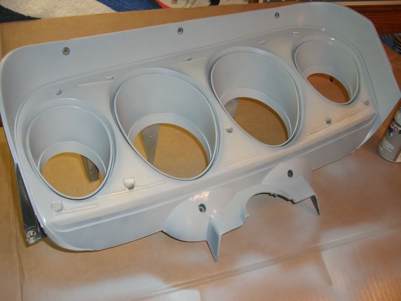

I took mine apart and painted it.
Before
I started by scuffing everything with a scotch brite then cleaned and primed.

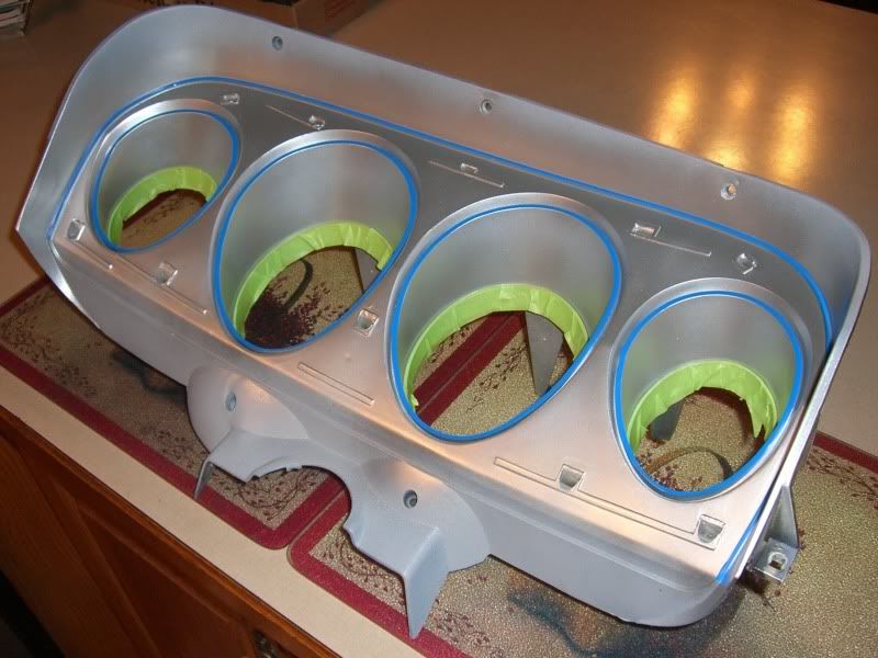

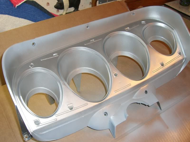

Then I coated it in silver
Taped off the parts that were to stay silver

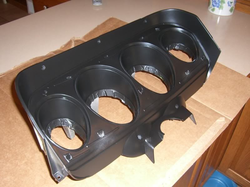

Painted it black
Carefully peeled the tape and assembled.
I'm sure it would've looked better sending it out to be chromed but it looks a heck of alot better than it did before and I did it myself for about $10 bucks.
