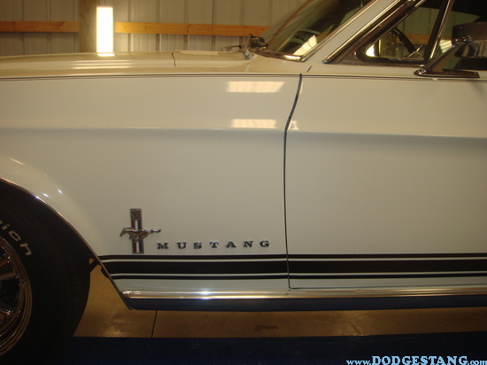

pic 2 i see a chip !

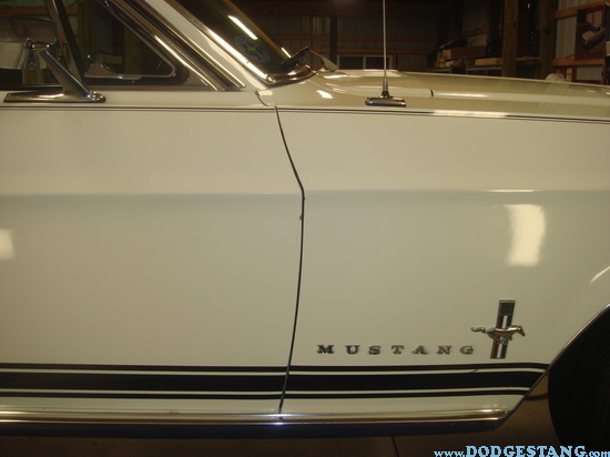

my goal during panel fit in the metal work stage was 3/32".
it's painted now and starting to get reassembled so everything is still getting tweaked. the only spot i really keep my eye on is the door to fender gap at the upper body line (69 mustang). this gets pretty tight when opening the door. All other gaps don't bother me at all.
the tighter the gap the more it will show imperfections. if your inconsistent by 1/16 on a 1/4" gap then it's not a big deal.
trunk lid to quarter extension
door to fender. this is the only spot of concern. i set the door and fender flush (fender doesn't stick out a little like originally specified).
