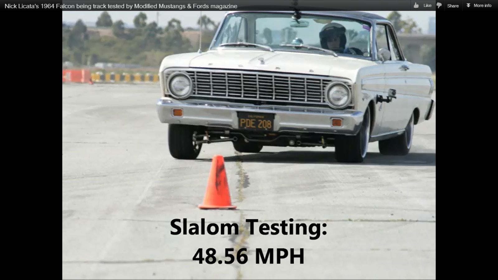

Since LSG asked me to here are the screen shots of the videos that he has been using to argue that our suspension geometry is less than optimal on our Mustang Custom IFS.
You can clearly tell that the Mustangs in the pictures don't handle very well and don't have enough negative camber gain.
On a serious note though this is exactly why you can't judge a book by a online video. The '32 in the picture actually has less static and less negative camber than the Falcon in the picture above it. Looking at the pics it sure doesn't look that way does it?

I'd like to see a still of the falcon at 1:05, at 1:54, and 2:20, and at 2:32. On The 32, what about the video at the 2011 'run to the coast' at 0:24, at 0:37, and at 0:45. I'm not seeing any obvious difference between the M2 setup and the "Custom" other than that the Custom uses more expensive coilovers.

I've made it pretty clear that you can't diagnose a suspension by watching a video especially when you're watching the wrong vehicles in said videos.
I will say it again and for the last time. You CAN NOT compare the camber gain of the stock front suspension to ours and expect that one piece of information will tell you how one is going to handle vs. the other. There are many other factors of geometry at play that I have already discussed so I am done with it. Our Mustang/Camaro and Nova Custom P/T kits are the only front ends using this goemetry so to compare anything else is irrelevant.
The factory MII suspension has positive camber gain during bump so there is no need to even compare pickup points with our Custom IFS or even our modified MII set-ups.
