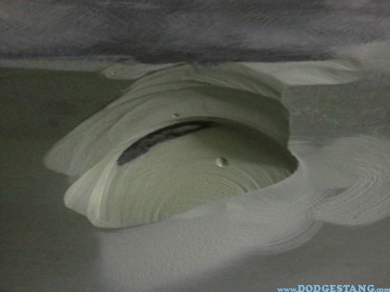

Who's heard of 'spray on filler'?
Status update....the sheer amount of fill on the quarters and parts of the door have slowed the stripping process a bit. But progress is still being made. The passenger side 'looks' like it can be salvaged, the driver side has spray filler on it, and it isn't all off yet so the final state is still unknown. Looks like the dents from the previous accident weren't really repaired properly and when pull didn't work they just layer up the fill and build the fenders out with it.

Holy cow, that's some filler for sure! That's what my lower quarters looked like underneath my paint... crazy how well filler can be hidden. Hoping that you don't have to redo too many (or any) repairs and that the PO just liked the quarters fat

Originally Posted by dodgestang View Post
I'm starting to get a little nervous....metal has been found.....but why on earth is there 1/8 to 1/4 of filler on the rear quarters?
consider yourself lucky. when i tore my car down, i found pieces of highway signs for floor pans, all held together with a gazillion pop rivets.
oh yeah, and the car was owned by a BODYSHOP.
