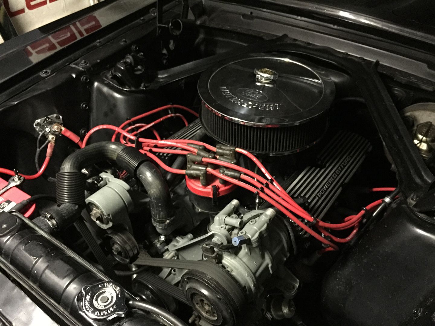

Around 03/04 I did a ton of work to it, including changing to black interior, bodywork and new paint and the flame job. It was at this time that I started plans for the 5.0/T-5 swap. It didn't drive again until 09, but when it did it was powered by that '91 5.0, freshly built with forged internals, aluminum WP heads, TFS stage 2 cam and a bunch of other go-fast goodies.

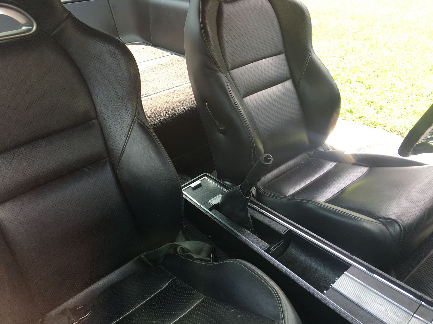

The best mods I've made to date (aside from a much more powerful engine) include the T-5 swap with modern driveline crossmember and Mustang Steve roller clutch pedal, power brake retrofit and clutch cable stuff. Honorable mention goes to the Acura RSX seats and customized stock console to accommodate the tunnel-mounted E brake.

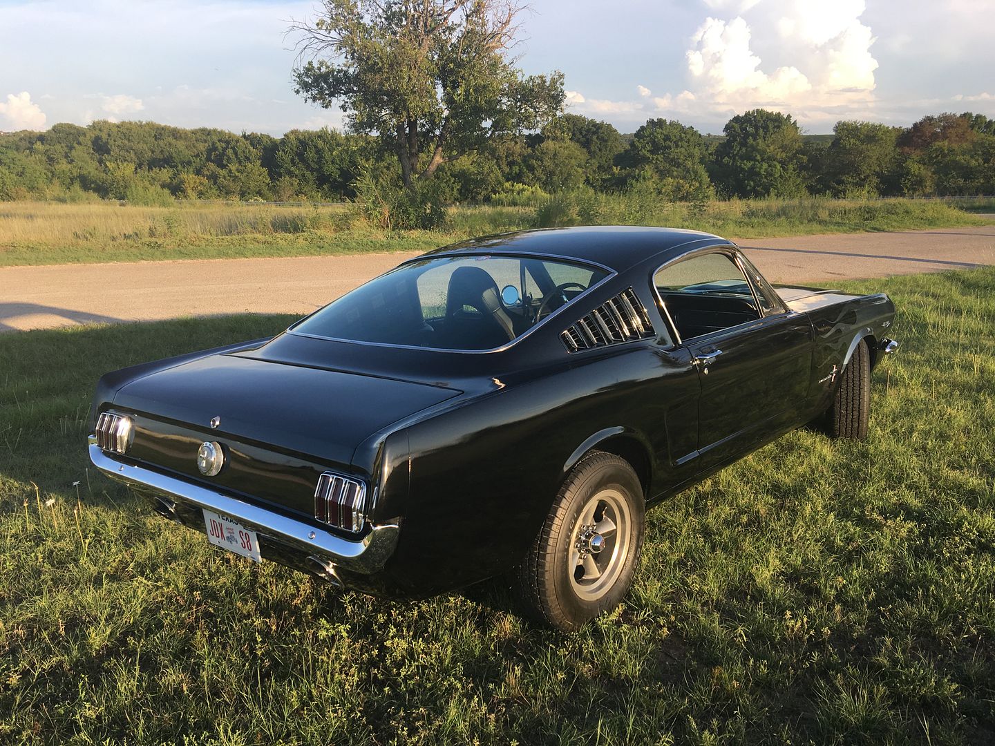

It sits lower than this on even ground. The grass gave me a bit of a 4x4 look on the sunlit side when I shot these this week:
Console includes a tiny amp that runs the speakers and has a Bluetooth module so I can run tunes off my phone.
The go-fast part.

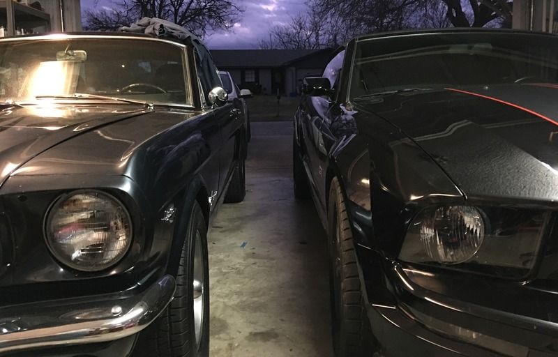

And just for giggles, my daily driver: 05 vert with a ton of Roush goodies and 442rwhp worth of Edelbrock E-force supercharger.
Makes for a nice view in the garage:

Two questions; What did you do to fit the RSX seats low enough and away from the armrests enough to fit? I had them in my 68' until recently and and found I needed to remove and replace the factory platforms entirely with reinforcing custom brackets down there. Then the challenge was to get them away from the doors. It was a close thing, but I did get it all to work and still have some headroom. I always wanted BMW E30 Recaro's though, and finally found a pair. They are getting very hard to find these days. Secondly, where did you get the parking brake handle from and how did you route the cables? That looks real nice and should provide plenty of leverage for the 8.8 rear you plan on. I have an Explorer rear too.

RSX seats are mounted to flat steel bars which are hard mounted to the floor. I'm the only driver so I really don't care that they don't slide. Even so, I'd prefer to lower the seat pans an inch or so one day. Such a vast improvement otherwise, I'm happy with the results.

Oh yeah, the parking brake... I got it from an 86 mustang. I positioned it based on what looked and felt right from the drivers seat. Cut the smallest hole necessary and it just turned out to be perfectly positioned to attach directly to the horse shoe bracket on the cable.
I'm sure I'll have to rework how that attaches to the 8.8 cable, but it'll be a fun challenge.

Ahh, got it. I had mine in there fully functional. The RSX seats are really nice, no doubt about it. The only things I didn't care for much were the modern style of them looked a bit out of place to me, and they are heavy, even after removing all the side airbag stuff. Even after I had them mounted I never stopped looking for alternatives. I bought some VW MK2's from a 91' GTI but soon learned they wouldn't work without losing near all function of movement. In the end I sold them for a nice profit so no harm done. The E30's are the bomb though, some of the best and most adjustable manual sport seats ever made imo. They only came in the BMW coupes though, the regular E30 seats are still all over the place, salvage yards everywhere. The Recaro sports have the adjustable thigh support for anyone looking. The E21 sport seats are terrific too, if you can find them.

I had some generic ebay cheapie racing seats in it for years. The RSX seats are so much better in every way, and I actually really like the styling. They don't scream 60's, but I don't think they look terribly out of place either. I expect I'll keep these in there forever.
