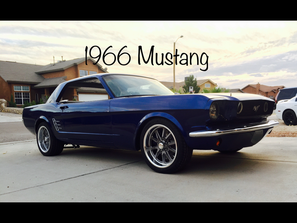

Your car looks great Blake! Really digging the flames and fastback! I had to go with a thin 215 on my fronts due to the deeper drop. Might be able to get away with 225 next time I need tires.
My car is just about complete, all windows are in, just need to finish seat belt installs , a safety switch, and a kick down. But here's my iPad wallpaper!
It'd be awesome if we could get a pic of our cars together

^^^ did you paint the window trim or is it not on yet?
I just got the ramblers in 18" for my 67 but not feeling them 100%. Might throw them on the 66 and see if I like it better

WIndow trim isn't on in that pic but I did paint them flat black, and powder coated the vent window, side window frame, and quarter window frames all black as well.
I also blacked out the quarter trim that's chrome In the picture
Honestly man, I feel the ramblers look amazing on vintage mustangs. Friend of mine has em in 18's on his 67 and it looks awesome

Look A++
are the tires 45 profile?

Thanks man! That would be so great to get our cars together. Too bad we're in the same state and still 9 hours apart, lol. Your car has been a big inspiration to me. I can't tell you how nice it was to have pics of yours to drool over while I waited a month to get mine delivered.

Yes sir. 245/45 and 255/45

This looks awesome. These are the wheels that we have decided to get for our 65. Haven't decided whether to go 7 or 8 inch wide. Why did you decide to go 7 inch wide?

I bought the 17x7 for front and 17x8 for rear. It was what was suggested for the early cars. And I'm glad I did because my front is just inside the wheel lip, which I just had rolled. If it were 17x8, it would've hit big time

No spacer needed I take it?

I did use a thin 1/4" spacer up front only because my cobra caliper was hitting the wheel on the COBRA lettering. Otherwise I wouldn't have needed it
