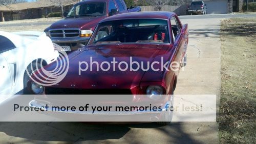

I've been looking at the MB Old School wheels and I'm trying to figure out what size tire I can run on the front without rubbing.. The wheels have a 4.74" backspace. I'd like not to roll the fender as I don't have the right tool, but if I have to I will. Here is the link to the rims:

Day I bought it:
How it sits now:
