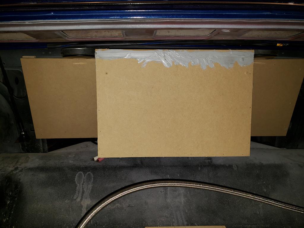

I got the radio antenna in this morning and built the divider board for behind the sub so you dont have to see the business. I made a little "L" bracket and metal screwed it to the back of the seat support. The antenna has just enough room to clear and not be in danger of touching anything metal. For those who dont know, you want to insulate your antenna from metal or it will, essentially, "ground out" and be pretty much useless.
Terrible picture but, this is the backside of the sub to show the sealed box. I liquid nailed the seams both inside and outside to make sure it's sealed. If you look to the left of the picture, you can see the radio antenna.
The divider board is test fit in to place. The plan is to mount both amps, the rear end breather / catch can, and fuel tank breather to the board in a fashion that doesnt look weird. My thought is maybe amps on the driver and passenger side with the breathers in the center. I intend to wrap it in black vinyl to match my plans for the rest of the trunk. I also have some #4 brushed stainless that I am going to use to make some accents for the wire feeds to the amps. I feel it would look tacky running wires through the divider without a purposeful panel if that makes sense.
Btw, this effort is probably going to reach a full stop after the amps are mounted to the board. I'm shifting my focus to making the car run and drive since it's really close to ready. Thus, this weekend's focus is probably going to be getting the front / rear windows installed, fixing a minor coolant leak, fix the toeing, seatbelts (3points), say prayer, drive...
