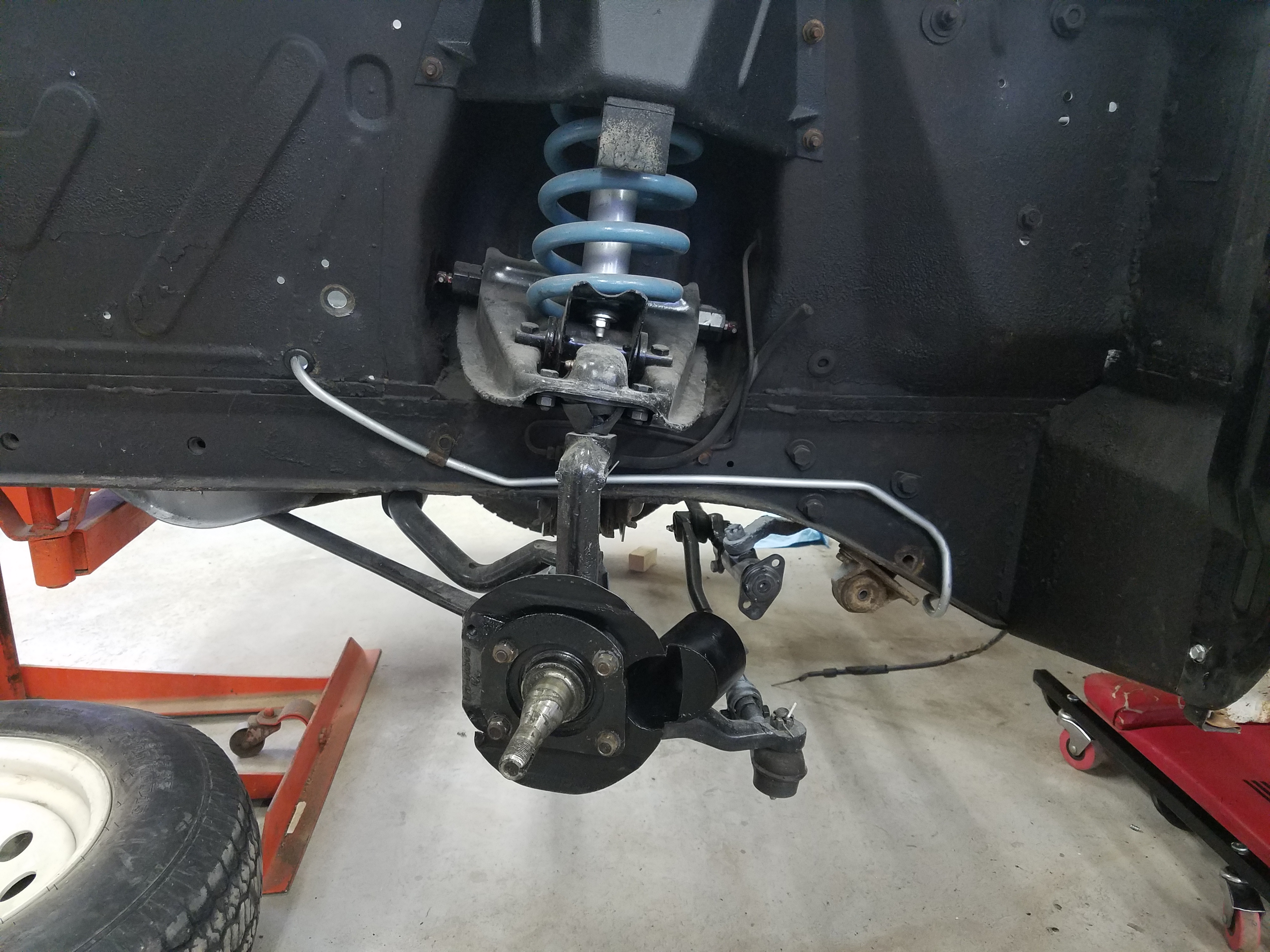

Here is the front suspension buttoned up. Rules require stock suspension but does allow some modifications. I bought replacement Moog lower arms, new Mood upper ball joints and shafts, and new Moog tie rods. I boxed in both the upper and lower control arms for added strength so they will (hopefully) survive the Mexican highways at 120+mph. I also added the "dogbone" shock tower reinforcements. I converted from power steering to manual by modifying the steering power valve and removing all of the hydraulics. Springs are factory rate with a full coil removed. I lowered the upper control arms 1" and moved the spring perch outward 3/4" to increase spring rate a little. The sway bar is 1.125" diameter. I added brake cooling backing plates on both sides. I haven't added the ducting yet, but I am planning on connecting them to custom cutouts in the valance to mimic the ones on the GT350s. Also note the 3/8 fuel line.
Rally rules do permit brake upgrades, however everything has to fit behind a 15x7 wheel. I opted to stay factory Ford for both both budgetary and nostalgia reasons. This car originally had 4 wheel drum brakes, but I was able to source some factory discs from a '66 off a VMF member. I rebuilt the calipers with new pistons, seals, and boots and added stainless lines.

Posts: 21
Nice Work.
What did you use to reinforce the upper control arms? I have laser cut pieces to do the lowers but couldn't find anything for the uppers.
