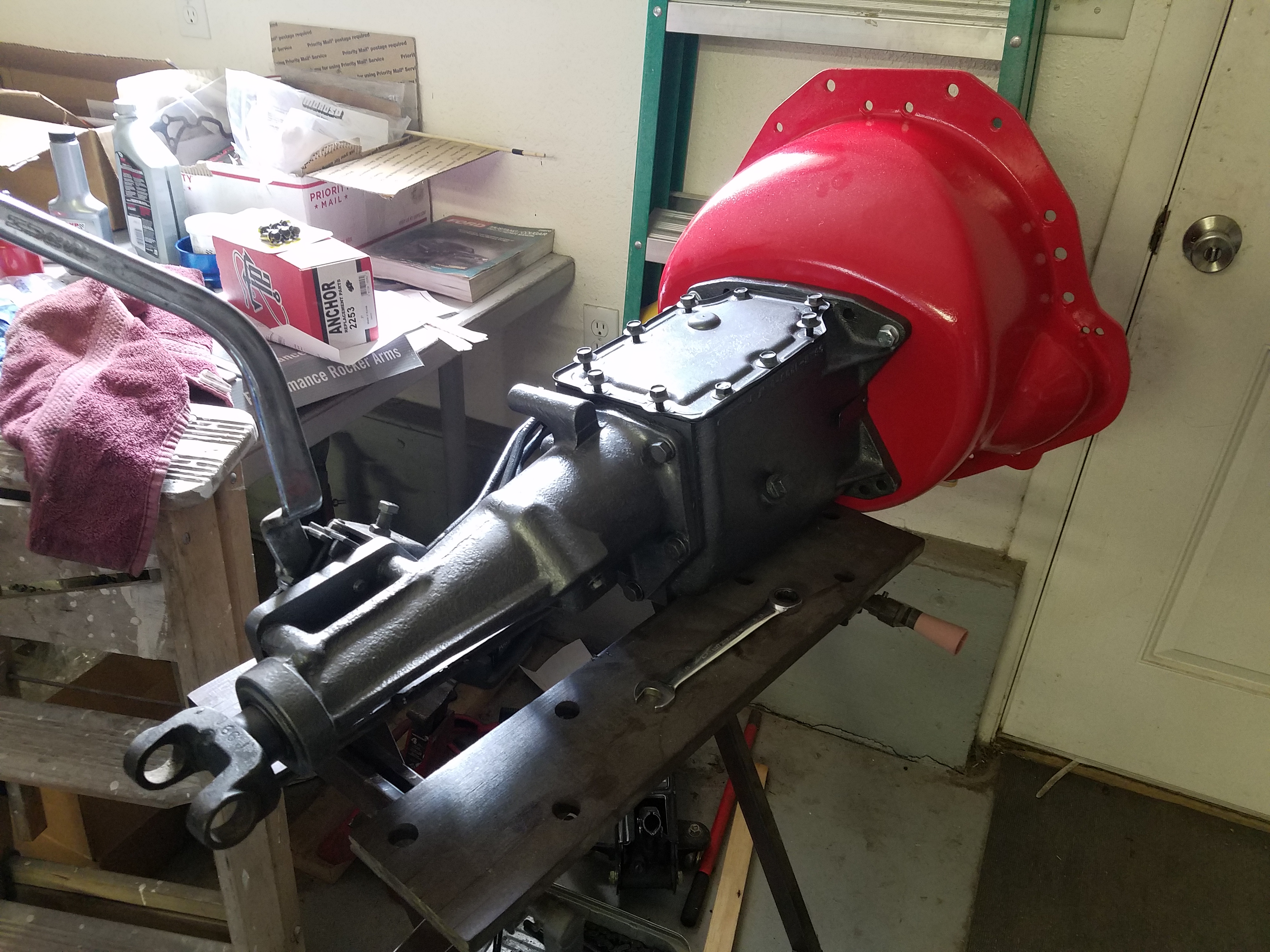

I guess I better start posting updates on the car. Per everyone's recommendation, I decided to go for a Lakewood scattershield. It's big and heavy, but looks really good, and the piece of mind is worth the effort.
Not sure with the newer Lakewood's, but my older model required offset dowels to dial in runout to within 0.01 TIR. I required 0.021 offset dowels, which was a substantial correction, as I was having difficulty shifting prior.
If you find you need dowels, RobbMc makes adjustable dowels that make it quite convenient to set the initial adjustments. Additionally, when removing the scatter shield in the future, these dowels allow the correction to be held in place.
https://www.robbmcperformance.com/products/dowels.html
Enjoying your build!

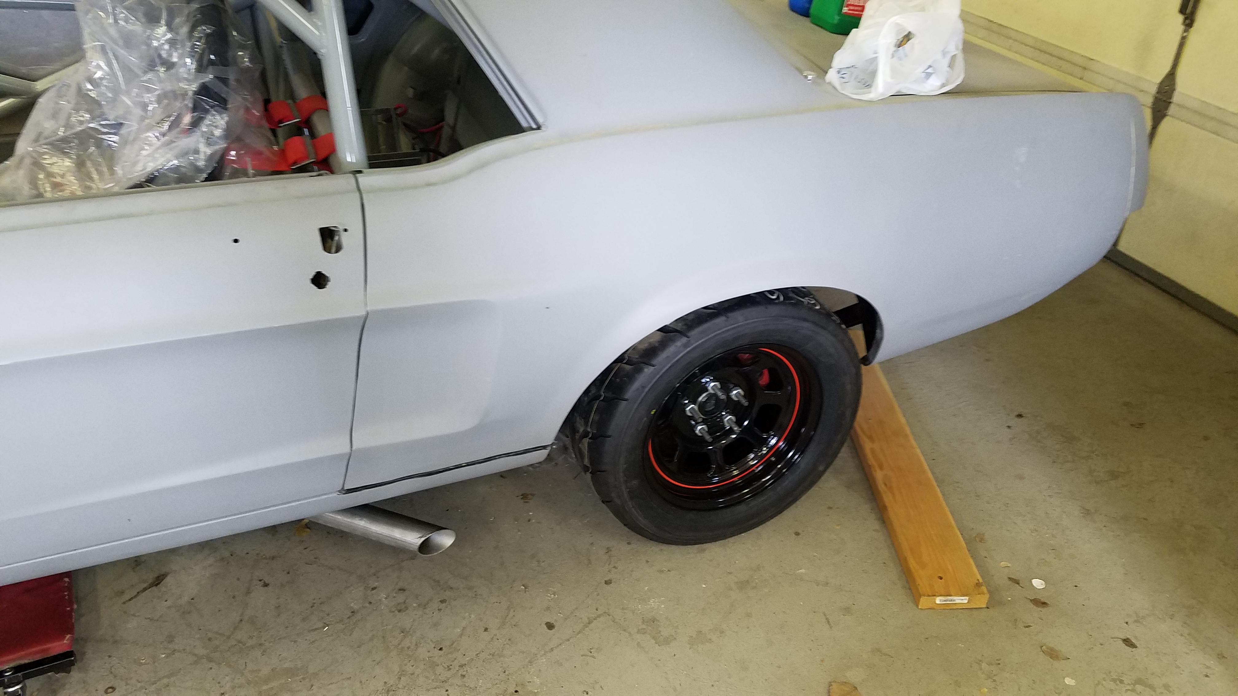

So the 235/50/15 will fit the front w/o rubbing or did you make changes for that- rolled/pulled fenders? Different suspension or will they clear stock?
I believe they will clear haha. I have a larger diameter (and wider) 245 on the front of my other car with essentially the same suspension and the offset should put the outside of the tire in the same place in relation to the fender. But I don't have them mounted yet, so I can't tell you for sure. Fingers crossed!

What's the backspacing and size on the Bassett's? you're using?

15x7 with 3.75" backspacing. I'll try and get them mounted in the next week or so to check fitment.

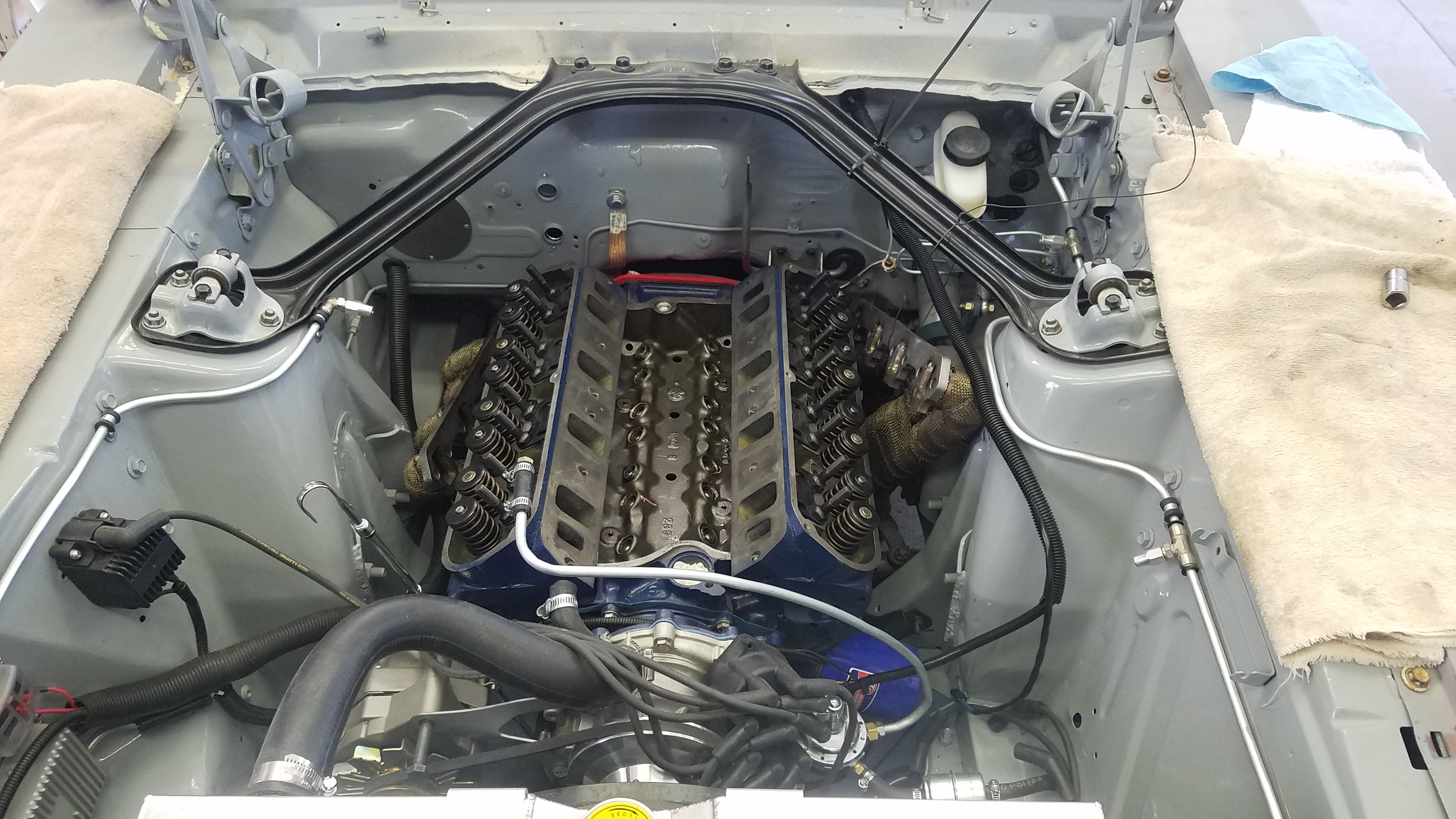

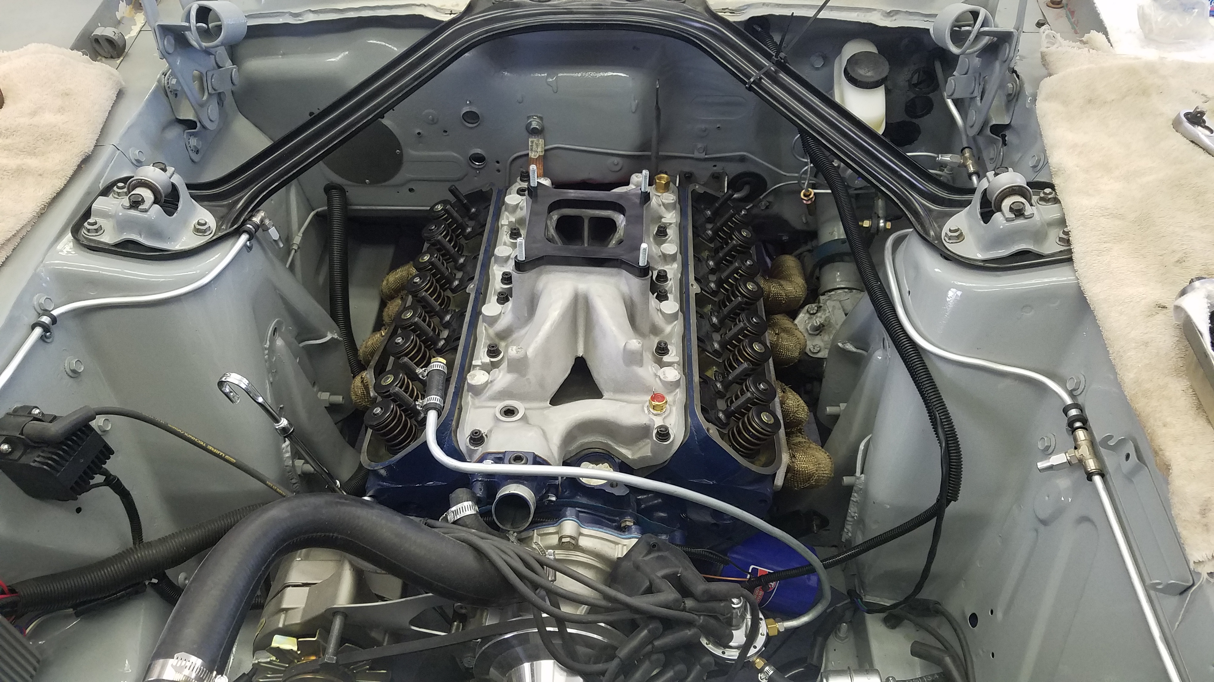

Got the heads back. 16 new guides, 1 new valve, and new valve jobs.

This engine is awesome. What heads and intake are those again? I saw the rest but somehow missed that part and now I can't find it!
Looks like an RPM AirGap (or similar)

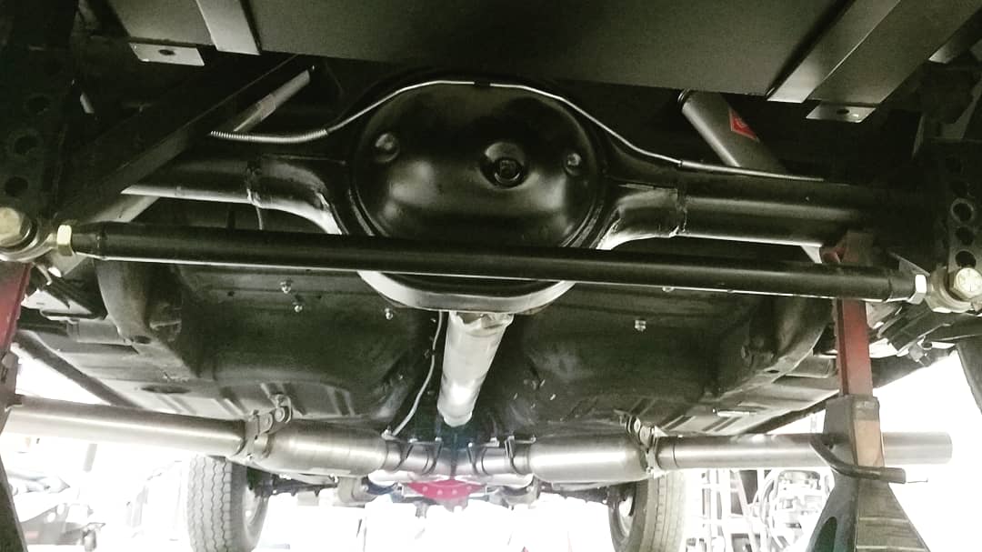

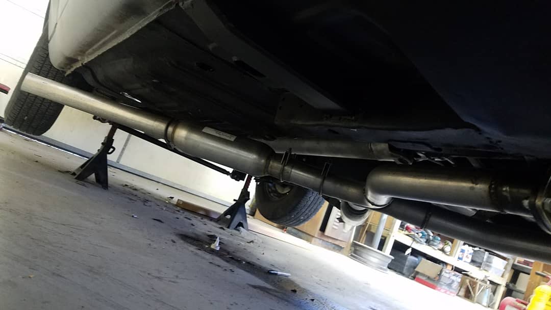

Anyway, while I'm trying to figure out that huge frustration, I got the exhaust finished up. 2.5" with X-pipe and 12" race bullet mufflers exiting out the sides.
I was able to run it (for a few minutes) with the exhaust on there, and it doesn't seem much quieter that open headers. And that was only at 2,000 RPM. Can't wait to see what it sounds like at 7!

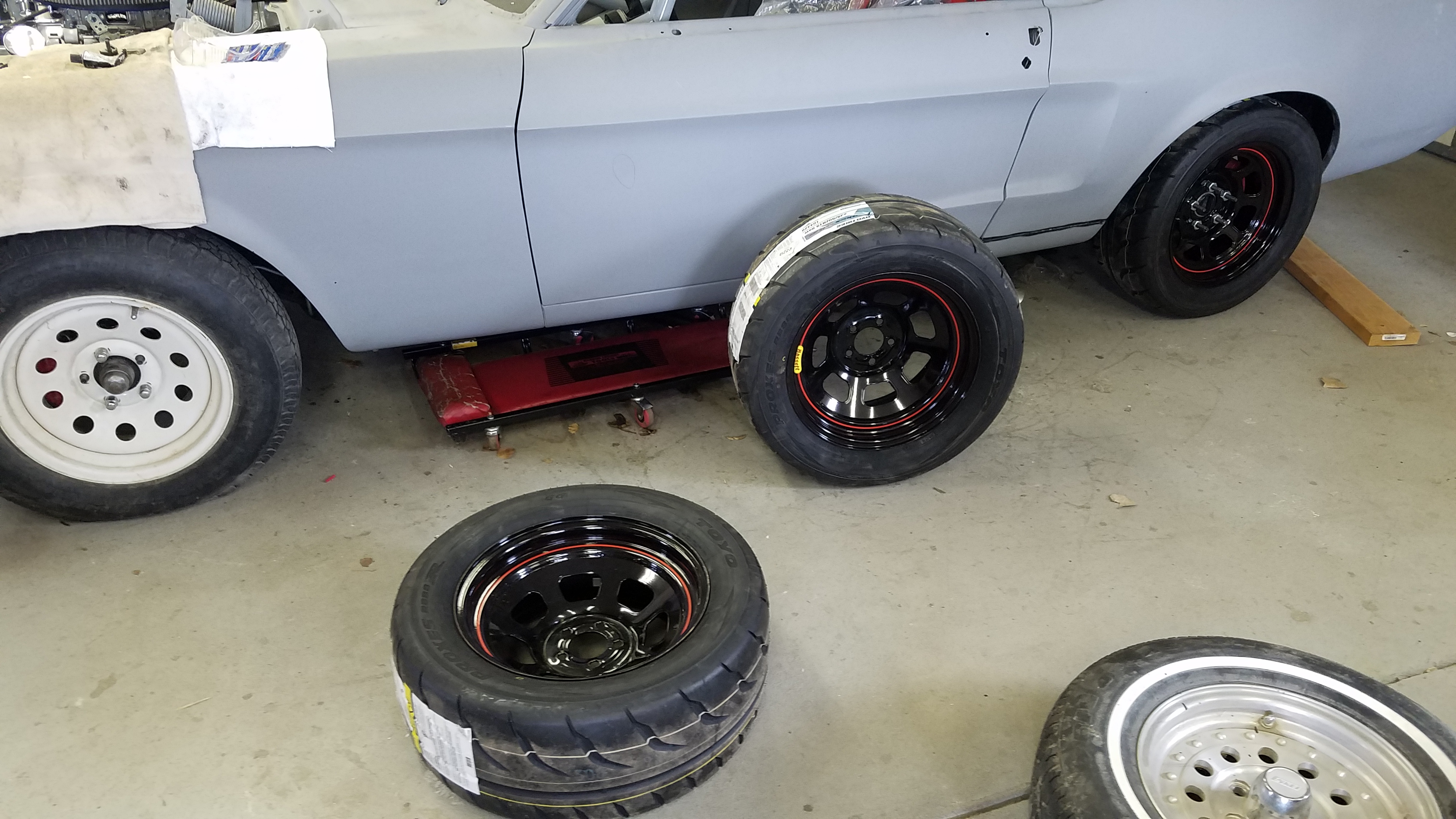

Got the tires mounted and balanced, and guess what. Only 2 wheels fit. The other two were 5x100mm. UGH. If it's worth doing, it's worth doing twice is this car's motto.
