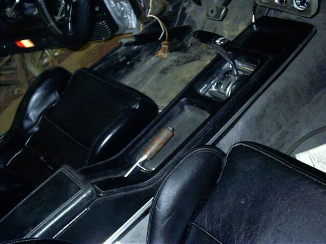

I had a slightly hacked hole in my dash from a PO putting in a newer single din stereo. I decided to make it an easy fix at the time (no welder on hand) so I put in a radio delete panel, and then added a double din touch screen to a center console. It was made to take one, stereo is easy to reach and use, and sits at a good angle to see it. Bonus is the cup holders.

Thanks Gypsy. Lets see if these images upload better. I seem to have issues getting the right file size to be able to upload without them being small. Also can't stop some of them from rotating. Let me know any tricks to uploading images - I searched the forum and cant find them. And photo bucket has left lots of posts missing the valuable photos!
This came with the dash cover and supporting brackets ripped off, so I smoothed it and called it good. A little rattle can action for paint and its looking ok. I have a matching tach and a size gauge bezel coming to finally move the tach into the dash.

Sweet! The console is growing on me too. Many folks make their own but they tend to be slab-sided and as there are hardly any straight lines inside our cars those curves make it look much more at home than most of those. Whether you made it or bought it, it looks good.
I just snap pics on my phone and transfer them to a PC then upload them to Postimages.org. Then when I need them I just link to them, whatever size they happen to be. People with slower connections may not be terribly happy about that though. I've noticed the pictures I took a few years back that were transferred over from Photobucket are smaller, about half the size. Ones from my newer phone put on Postimage transfer the size of the first picture. Older ones the second picture. I never messed with the sizes. Ain't nobody got time for that.
