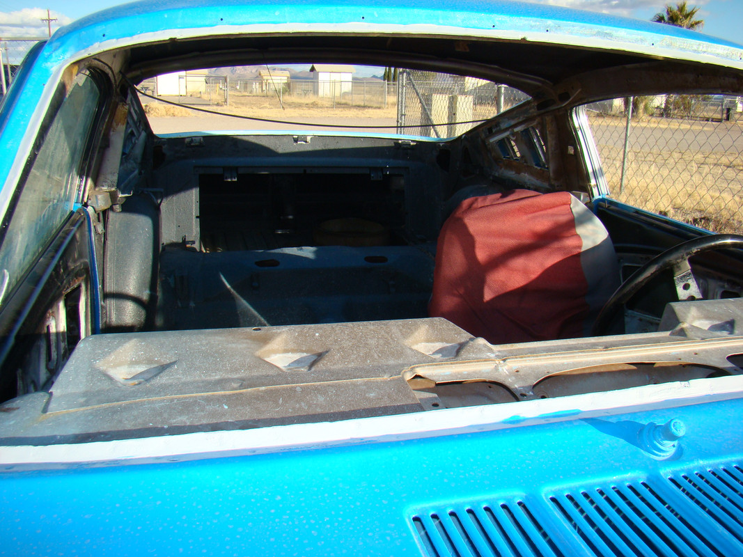

During my Army career, the Mustang went through various changes. I used it as a daily driver, so it picked up dings and dents along the way. Whenever a body part was damaged, I would just replace it with a part from another Mustang being parted out. It became known as the "calico" Mustang due to the different colored parts on it. It sat in a friend's backyard for 3 years when I went to Germany, and another year when I was stationed in Korea. Got married a couple of times, and had children, so the Mustang was being driven, but no bodywork or paint was being done. It actually became an embarrassment to drive it around.

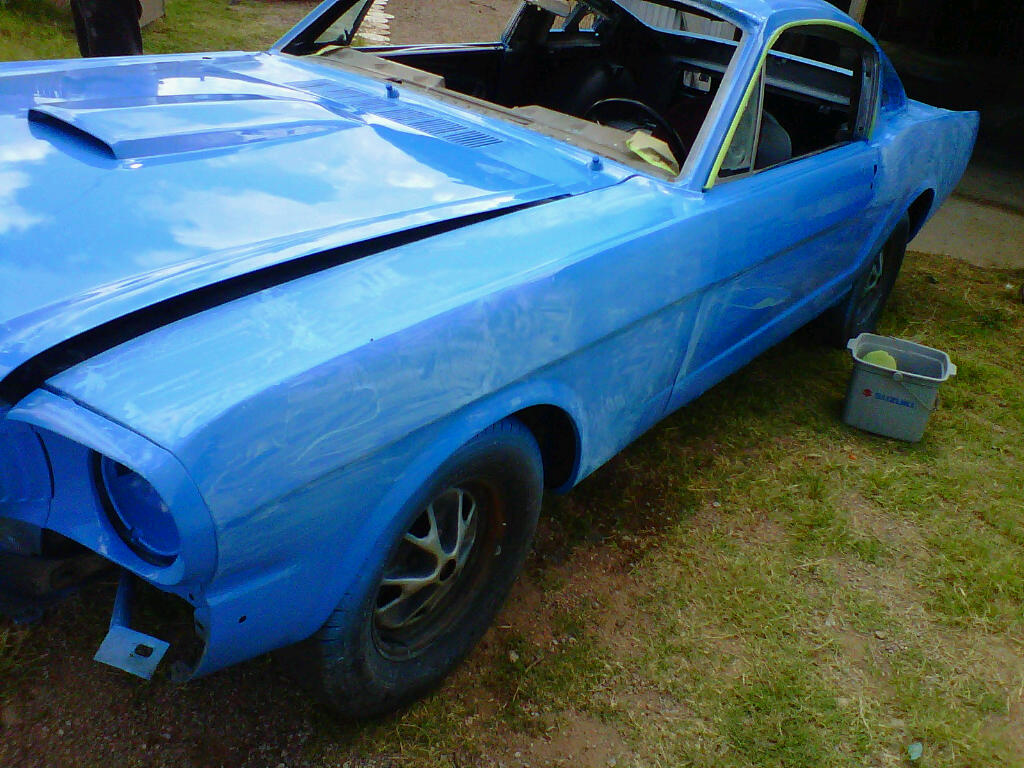

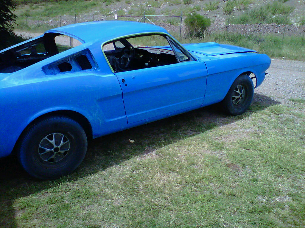

In 2010, I finally got the Mustang painted the Grabber Blue color that's on it now. I did various engine and suspension upgrades to it's current condition. It now needs another paint job as the person who painted it talked a better game than what he could play. I still drive it almost daily when it's not apart Currently the engine is a 289 with a stock crank and HiPo 289 connecting roads and Sealed Power forged pistons. The top end is a Blue Thunder dual quad manifold with a Holley 600 as the primary carb, and a Holley 390 as the secondary. A Carter electric fuel pump sends the fuel from the gas tank to the engine. The ignition is a Pertronix II with a Flamethrower coil and Ford Racing wires. Heads are Twisted Wedge 170's with Trick Flow roller rockers. The cam is a Comp Cams XE262-H grind and Comp Cams lifters and push rods. The exhaust is a pair of Cyclone headers that have been on there since 1981, with a generic dual exhaust with the GT trumpets that exit out a GT rear valance. The oil pump is a standard Mellings unit with an upgraded shaft. The oil pan is stock and a Boss 302 windage tray keeps the oil from the crank and rods. Cooling is a Champion aluminum radiator, hi volume water pump, and a clutch fan. Transmission is a Ford Toploader 4 speed out of another 65 K-code Mustang with a Hurst shifter and Ram clutch set. I installed an Explorer aluminum driveshaft and the rear end is an 8" with 3.55 TractionLock and Moser axles. Braking is a pair of Kelsey-Hayes 4 piston discs up front, stock rear drums, and a dual bowl master cylinder. The body has a open front valance that directs more air to the bottom of the radiator, a hood with the 65/66 Shelby scoop, and a GT rear valance. Suspension has the Shelby/Arning drop on the front, heavier springs on the front and rear, and KYB shocks all the way around. Interior has the fold down rear seat removed and replaced with a 66 Shelby rear shelf where I keep the spare tire mounted. Stock front buckets, full length factory console, 5 instrument gauge cluster, 65 Shelby gauge pod with a Stewart Warner tach and a clock. When I'm in the mood for music, I have the stock AM radio in the dash, but it powers an amp that's located under the rear panel and I hook up my phone to it to steam in music. I have manual steering with the 4:1 steering box rebuilt by Chockostang, manual brakes, no AC - just the basics.

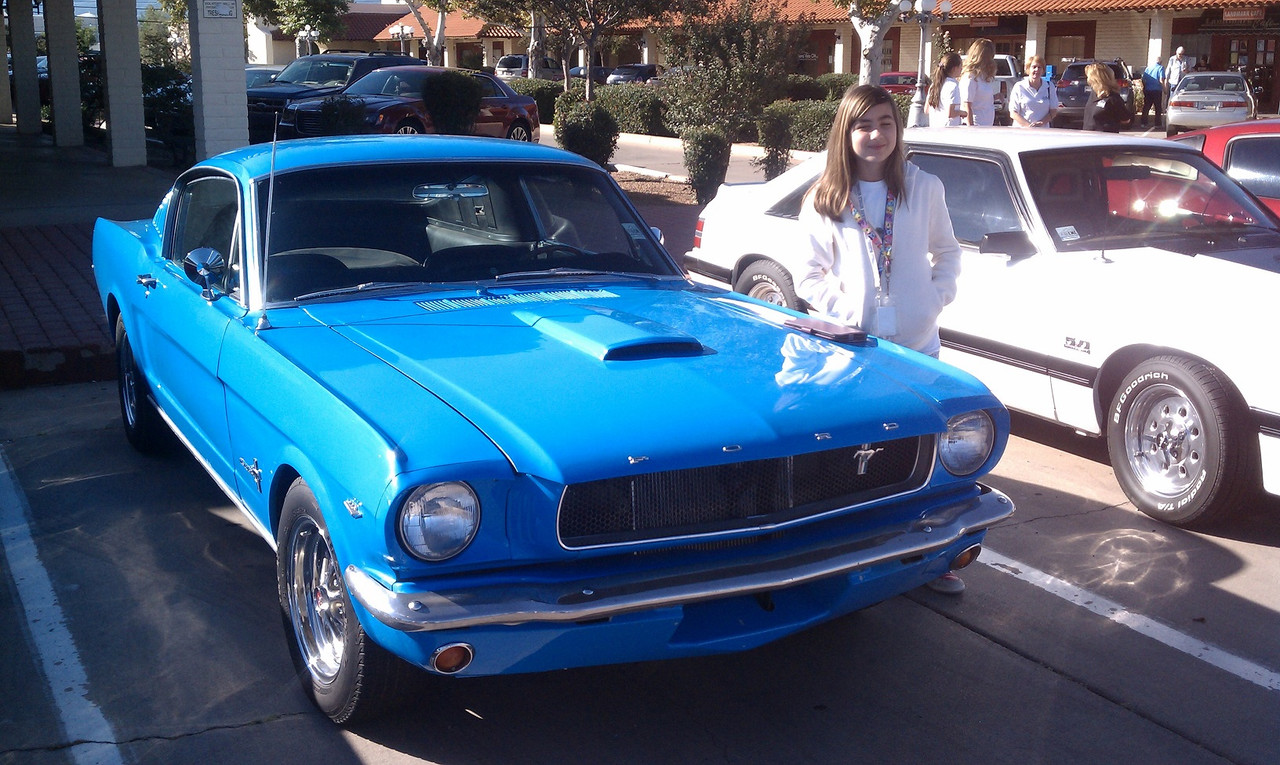

Like I mentioned before, I try to drive it as much as possible. I have had a lot of adventures in, both good and not so good. My wife is always wondering what I'm doing with the car "now", and I try things out to see if I like it or not. I take it to most of the local car shows around here, but don't win anything. My family wonders why, and I tell them that it's a daily driver that can't compete with the others that don't get driven. I have small dings here and there, the paint is fading, a small crack in the windshield, dirty undercarriage, etc. But I bought it to drive. In 2017, I drove to Reno for Hot August Nights, and put in 2600 miles in a week. This spring I'm registered for the Fabulous Fords Forever show at Knott's Berry Farm and will drive my Mustang to that one. I love the comments and thumbs up I get when I'm out on the road because other than body work and paint, I've done everything myself on it. In a few months, my youngest daughter is going to be getting her learner's permit to drive, and I'm going to get her started on the Mustang. I told her that if she can handle the clutch and shifting on this, she'll be able to drive just about anything else on the road. There's a local airport that was a World War II bomber base, and it has lots of open runways and adjacent roads that aren't used. It'll be an adventure!

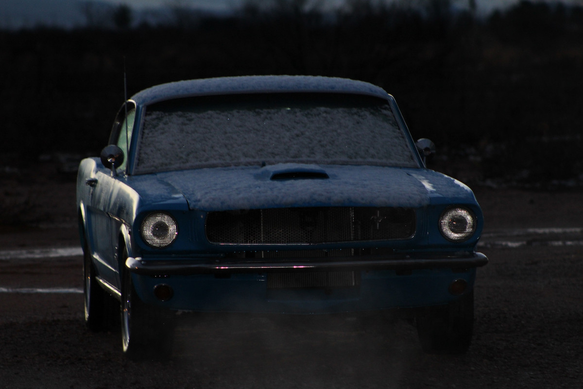

congrats ,Awesome pic BTW

I took this picture at night under a full moon. No flash or other light. I like how it came out.

Don't get me wrong still a great pic ,but for me it takes the sinister out of it versus the darker version
