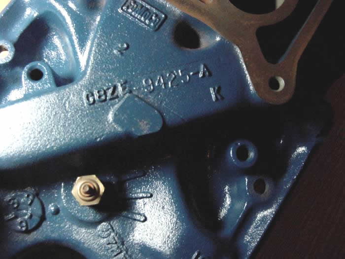

I have the original 4300 carb and I found an intake manifold with the number C8ZE-9425A and a Date code of 7H30. My question is, would this be a 289 or a 302 intake? My engine is a 302 J code.

The date code is a little early ( depending on the casting dates on your block and heads). But it is the correct intake for a J code 302. I'd go with it.

I just looked at the intake #'s on a '68 J car.
Intake C8ZL-3435-A
K
Dated *7L27*

That L is probably an E:

The only reason the 68 4V manifold had a unique number was insignificant details changed for 68. But it is most certainly a 302 manifold, because there was no 68 289 4V. After 68, there was no 302 4V either.
And before some wag brings up the BOSS, that was a completely different engine.

A fresh set of eyes says yes, it is an E. Thanks.
