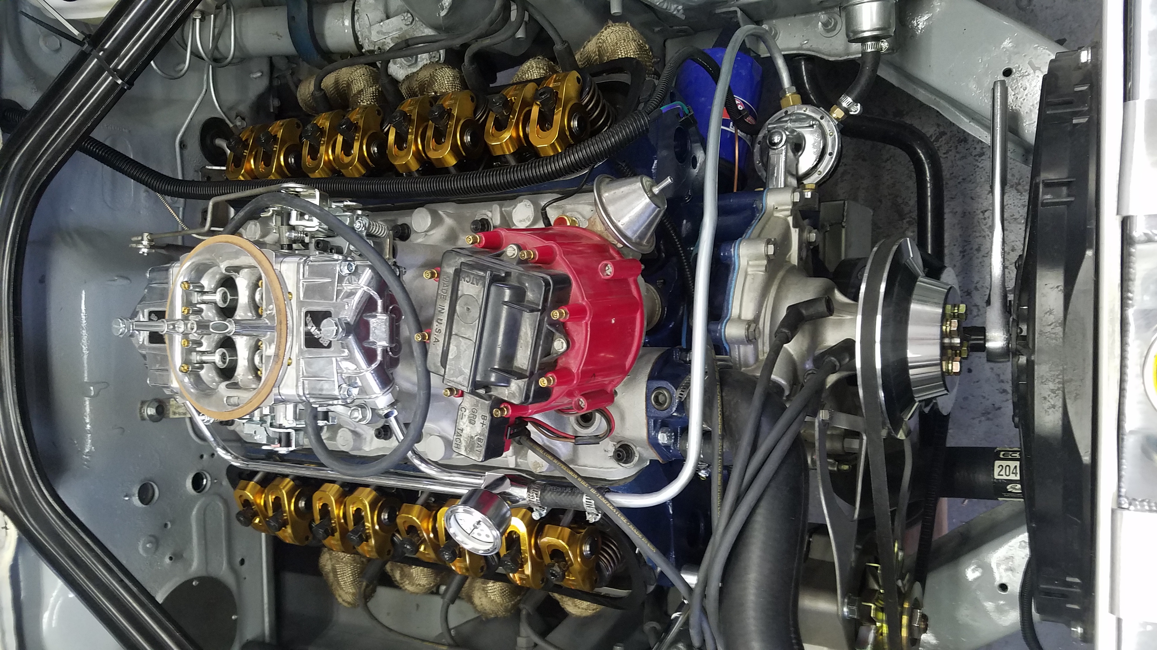

I started it again this morning. Ran great again, but for less time. Probably only 5 minutes, and the temp needle didn't move until it started running really rough again. It stayed running rough longer this time (instead of bogging down so much that it would kill), and I tried to give it a little throttle to keep it running. It would react to throttle, but not great. After it died, the heads weren't hot enough to burn your hands. In fact, I could hold my hands on them (the thermostat hadn't opened yet). So now I don't know if it's heat (or sticky valves) related at all. Could be faulty electronics in the ignition as you mention. The coil and ignition box are away from any heat on the fender well where the battery would normally go, but that's not to say they aren't getting hot internally...

The pistons are hypers and the top ring was clearanced to .018" to .020" as instructed. After I ran it today, hot, it felt about normal to turn over with a wrench. The temp gauge did not move before it quit this time. The thermostat didn't open. Water in the radiator just started to get warm and I could still put my hand on the heads after it quit. After it sat around for a minute and the heat made its way into the intake, the temp gauge moved up to about 160.

It was definitely not easy to turn over when warmed up. And I did double check the valve lash when hot, and it wasn't changing.

I did speak with them yesterday, and they had a few ideas (head gaskets, etc.) but nothing really jumped out. I started it again today to check the cooling system and although it quit before the thermostat opened, there was no obvious issues like bad head gaskets, wrong water pump, etc.)
So far, I'm still at a loss. Starting to think it could be something to do with the ignition now as this last time it bogged down and quit before it got very hot at all...

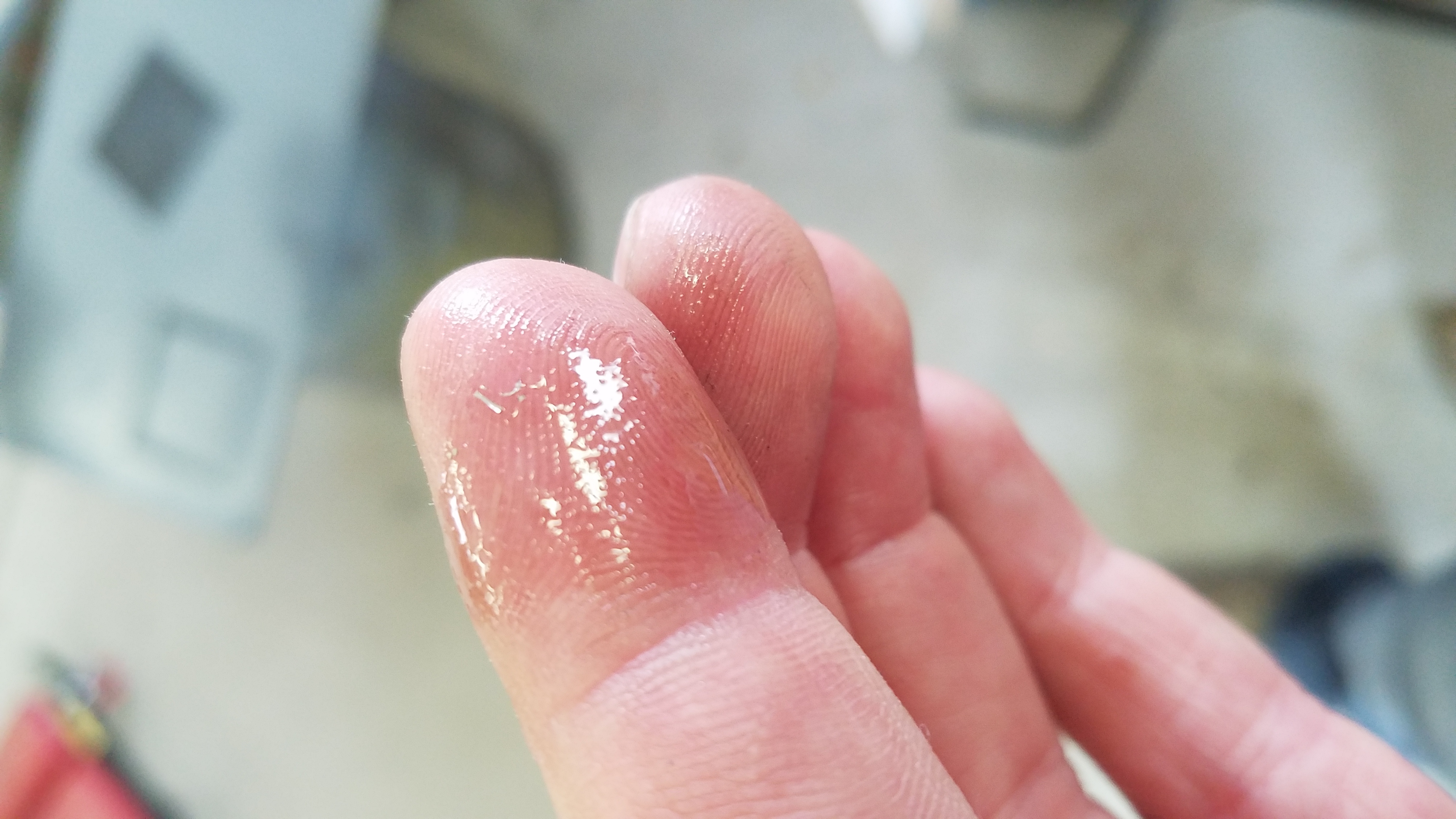

Well, I have eliminated any ignition issues. I forgot that my other Mustang has a 1-wire HEI distributor, so that was an easy hookup. Ran great for a few minutes, got my hopes up, then bogged down and started running really rough. It stayed running this time, and I revved it a couple times which temporarily "fixed" it but would go right back down into a loaded bog. It definitely sounds like something is binding with the heat (although the motor itself isn't running long enough to get real hot). I did notice there was gold/brass looking flakes in the oil. Both on the dipstick and under the valve covers. Not sure if it's just from the break in or something more (probably something more due to my symptoms). I used Clevite bearings, non which would be gold/brass Cam bearings: https://www.summitracing.com/parts/cle-sh1321s, Rod bearings: https://www.summitracing.com/parts/cle-cb634a208, and main bearings: https://www.summitracing.com/parts/cle-ms590p20 (.020/.020 crank) I plastigauged all the bearings during install, but I am thinking that I never checked the thrust...
So what do I do? Pull the pan and start removing mains and rod caps to inspect the bearings? Or should I pull the heads and check the valves/guides?

Gold/Brass colored is NOT good. Didn't you say they installed BRONZE guides? Other potential sources, if you have bronze/brass installed are distributor gear and camshaft thrust plate. The other possibility is crank thrust bearing. Do I remember correctly that this has an automatic behind it? Converter pushing against the flexplate?
Yes, it does have the bronze guides, and I had problems with sticking valves first go around, but I got the heads rebuilt with new guides and they said the honed them out more so I wouldn't have that issue again, but I still can't rule it out. Might be worth pulling the heads again (PITA) and pulling the valves out to look at them. Both the distributor gear and cam thrust plate are iron so we can rule them out. I'm thinking about pulling the pan and checking the crank thrust bearing to see if there are any obvious wear signs on it.
