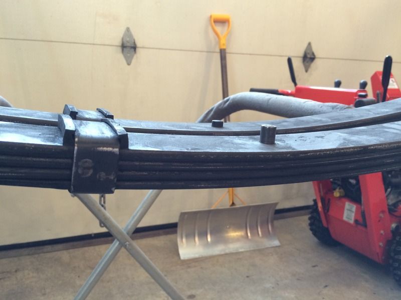

If you go with Eaton, see this thread for the rear. Apparently the little axle nub is too damn small, so you need to install a larger one. My originals broke trying to remove them so just buy new ones when you order the springs. Clamp the springs on each side before loosening/removing it, then just install the new one and tighten it down.
https://forums.vintage-mustang.com/vintage-mustang-forum/951257-1965-8-axle-rebuild-help-2.html

I spoke to two NPD guys who seemed very knowledgeable on Eatons one guy on this forum from NPD even says he knows the....never mentioned this. Never saw that part on the site.
What are these nub things called?
Also, don't the NPD Eaton springs come already bound together with their spring camps that you have in the photo? or are you referring to the u-bolt clamps.
Ok...Ok so I think I found what these things are. They are called centering bolts.
There are 3 types (of course) listed for all the years. I'm going to guess the biggest one is the one you had discrepancy with.
