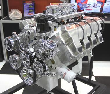

For somebody that WANTS a correct (and serviceable) 351C block & heads with date-coding a plus then maybe it's worth it but then think about it....
It's got the same 4 inch bore and 3.5 inch stroke as a Windsor. The bore spacing is the same, it's the same 90* between banks... Because of the additional .3 inch deck, the Windsor runs a longer rod and it also has beefier main and rod journals. They are balanced the same at 28 oz/in imbalance. The Windsor's oiling system is superior.
In essence, it's all about the heads, or should I say "head design". Just like aluminum aftermarket heads for Windsor's there are choices in Cleveland heads for 351C blocks or for use with 8.2 & 9.5 inch Windsor blocks and a "Clevor" intake. However, if you're going to go through the expense of building a killer 351W-based motor, wouldn't it look (and run) sweet with some Hammerhead HEMI heads?
Spending his money, are we?
