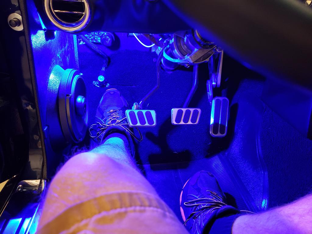

Do you have any issue with the speakers/spacers interfering with your left foot when working the clutch pedal? Can you still get to the high beam switch ok?
Any pics of the finished install?
Plenty of room for the clutch. I have the dimmer switch mounted kind of high but you can see that there's plenty of clearance regardless. The spacer looks a little 'donut-ish' but it does the job. I've never been too concerned about it since it's under the dash.
